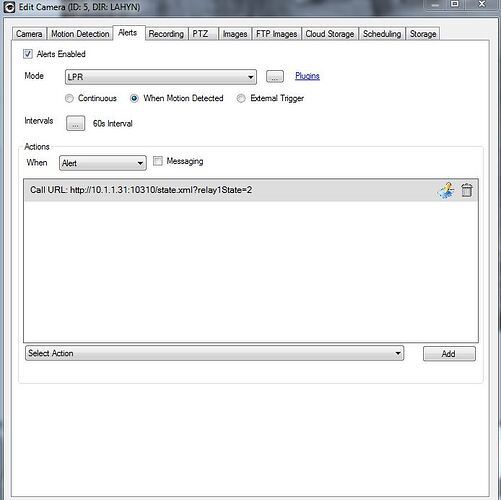

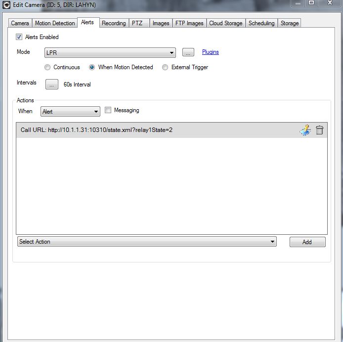

In parallel, I had a surveillance platform (iSpy) Agent DVR Feature List running on a VM, with an ANPR plugin that white listed car registration plates. - On detection of a white listed plate, the iSpy ANPR plugin would generate a HTTP URL string / command? and this would pulse the corresponding relay in the gate controller and the gate would open.
String that iSpy would send:
The solution worked quite well, and family and friends could drive up our driveway and the gate opened. Cars or other objects not on the white list had to use the intercom.

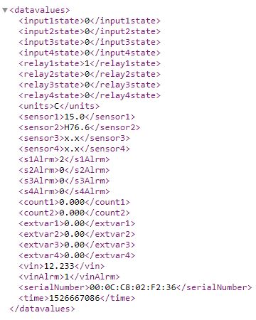

The X-310 from what Ive tested - if I type the following into the browser:
http://10.1.1.33:10330/state.xml?relay1State=2
changes the relay state accordingly and responds with:
Is this response sufficient to extract the variables that openHAB / homekit would need, in ordere to inform ‘siri’ of the status?

4 relays, 4 inputs, and up to four sensors? These are awesome devices! I’m guessing that the relay1state is representing the state and a 1 indicates ON.
Certainly. It is valid XML so you would probably use the XPATH or XSLT transform. If you ommit the “?relay1State=2” do you get this XML back without changing anything on the device? That would be good because then you can poll the device and capture manual changes to the device’s state.
