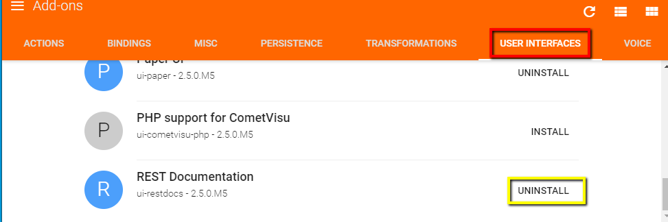

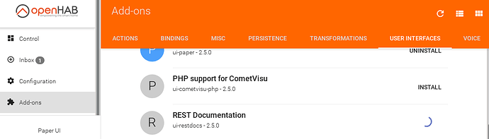

paer-ui has no entry for REST uninstall, there is an entry for Install in the User Interface tab but it fails when clicked (circling the icon endlessly)

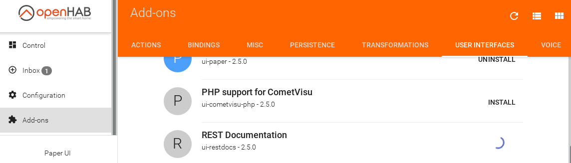

thanks!, that file had escaped me before . ārestdocsā was sitting there in the misc= line and I removed it, restarted openhab2.service and tried paperui for installing the addon again.
The icon still circles but: in addons.config an entry for restdocs was added in the ui line ui="basic,paper,habpanel,restdocs"
and the log has none of the messages any more.
A further restart of openhab2.service lists the Rest Documentation as not installed though.
So it seems to be in a half-installed state now, as it is working but not shown as such in the paperui.

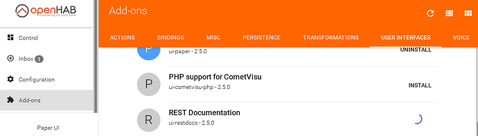

After a while a new entry appeared in bundle:list, there was openHAB UI :: Bundles :: openHAB REST API Documentation
Iāve had a number of confusing out-of-sync states between paperui, bundle:list and the REST API in the browser but now things look as expected.
What seems to have made the trick was installing another āmiscā addon through paperui which appeared in the addons.config with a leading comma, ",hueemulation".
Like the footstep of a ghost.
I deleted that comma, saved the .config and unistalled hueemulation again and that apparently fixed things.
