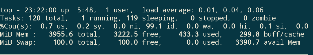

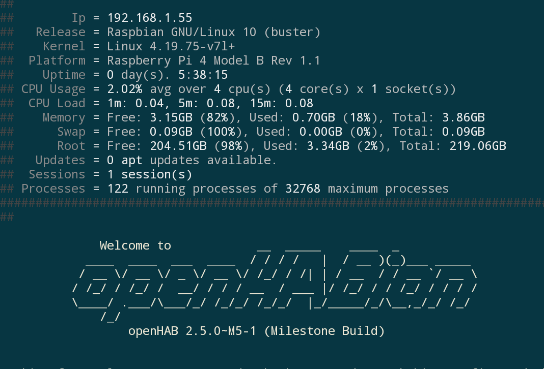

My top is really light. The used memory and cpu is very low. So, I can say on openhabian mqtt binding don’t leak memory or cpu. Actually I never seen all that free memory with openhab. I use openhabian plus zigbee2mqtt on this raspy
