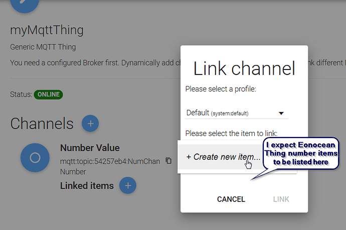

MQTT Link Number item - items missing
I configured a number type channel for a generic MQTT thing using paper ui
When I add a link to this channel, I expect all number type items of my things to be listed. But the list is empty and I have only the choice to create a new item.
This works perfectly OK in 2.4 stable
Background
My sandbox setup is on openhabian buster with mostly just 2 enocean devices (NodonPir and Nodon Plug).
I want to publish LUX values of my automatically discovered Nodon PIR via MQTT
Linking On/Off items to ON/Off Channel Types works as expected
