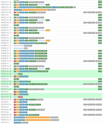

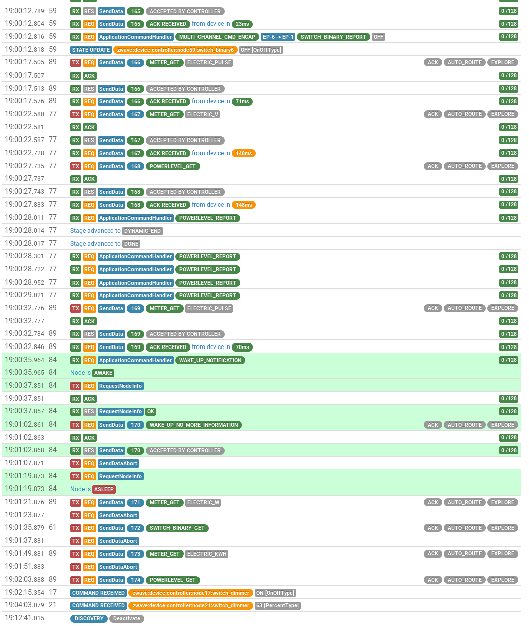

Here’s a snippet with about 10 mintute delay;
Node 84 is a battery device. Not sure if it has been 84 previous days.

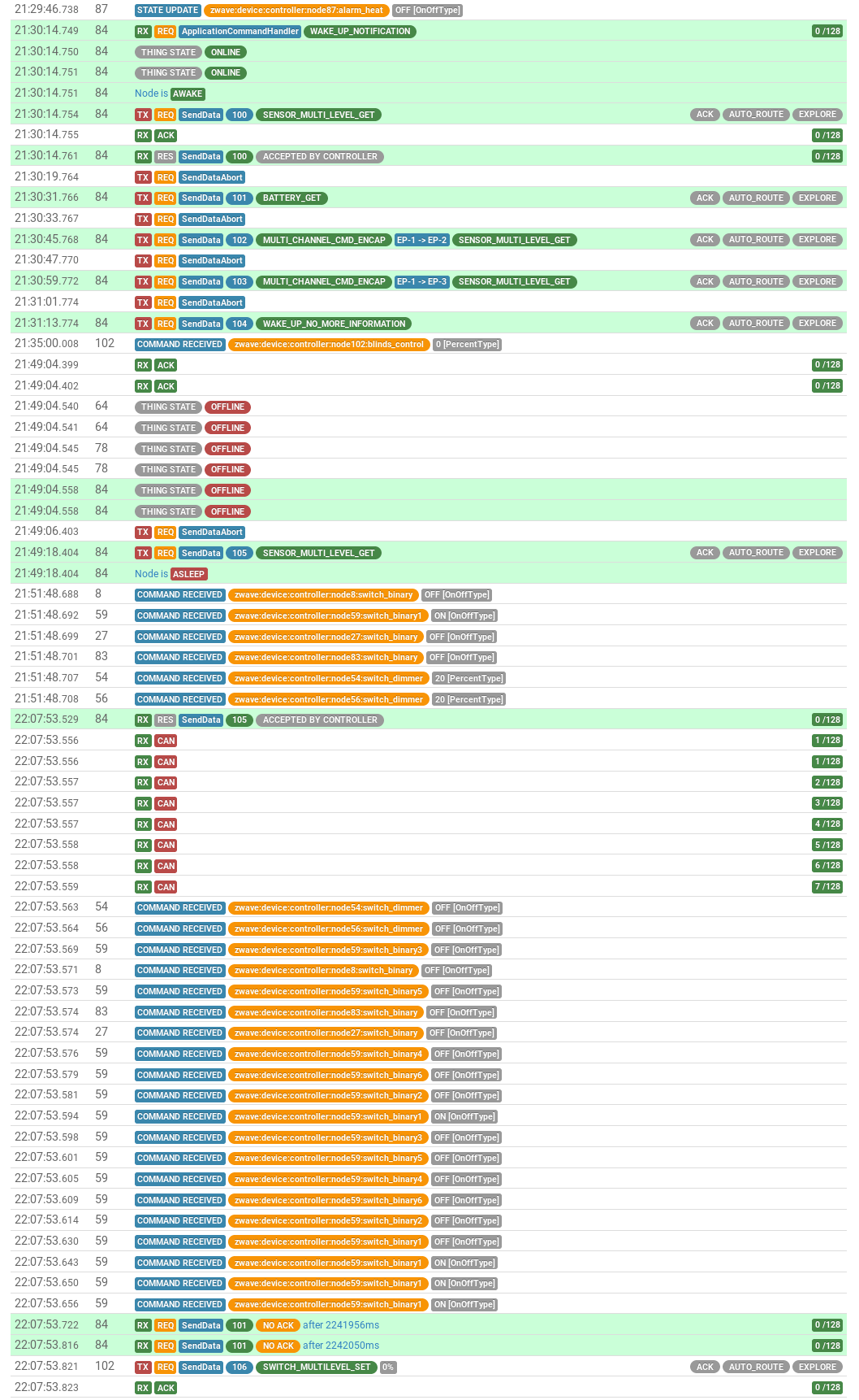

So, I decided to do some more testing. I deleted the thing, inserted the batteries and woke the node manually. Not much seemed to happen, so I restarted oh, woke the node re-added the new thing from inbox. Then after a wile the controller hung again. I stopped oh, pulled the controller and reinserterted it again, and started oh, a last time. The network seemed to work until:
So I closed down oh again, removed the batteries of 84, pulled the controller and reinserted it again, and restarted.
I have the complete log since the last restart, if you @chris are interested in this. I don’t mind putting my old 84 into the recycling bin, but if this is might help others upgrading to 2.5, it might perhaps be useful.
