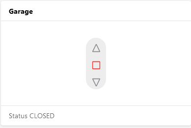

My page looks like this (with a rollershutter)
yes, create an empty rollershutter item and process the commands it receives from the component widget in a rule just like yours.
