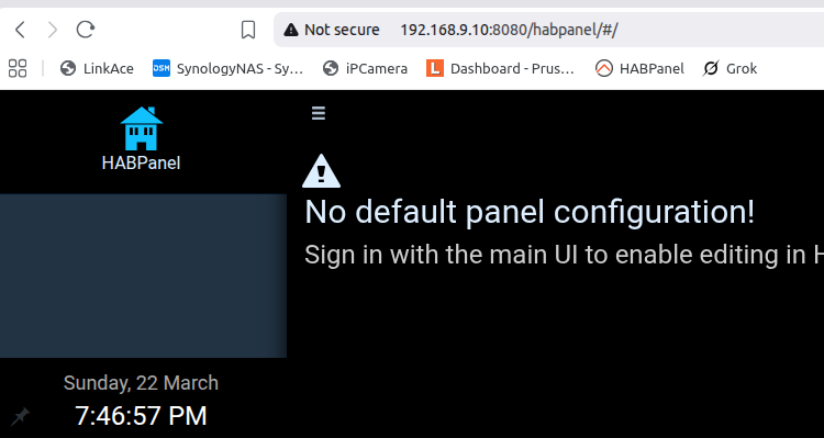

3.4.3 -> 5.1.3 = 2 hours; black screen on HABpanel, and none the wiser after 10 hours of trying
This is related to Upgrade from 3.4.3 to 5.1.3: habpanel shows black screen
However, since then I read the docs, forum, tubes, AI and nada; I was unable to fix it. Worked on 3.4.3; does only work on my dev machine; no other browser or devices.
I am unable to find the “star” or any UI setting to set a default page. I wonder how this worked before.
Any hints appreciated.

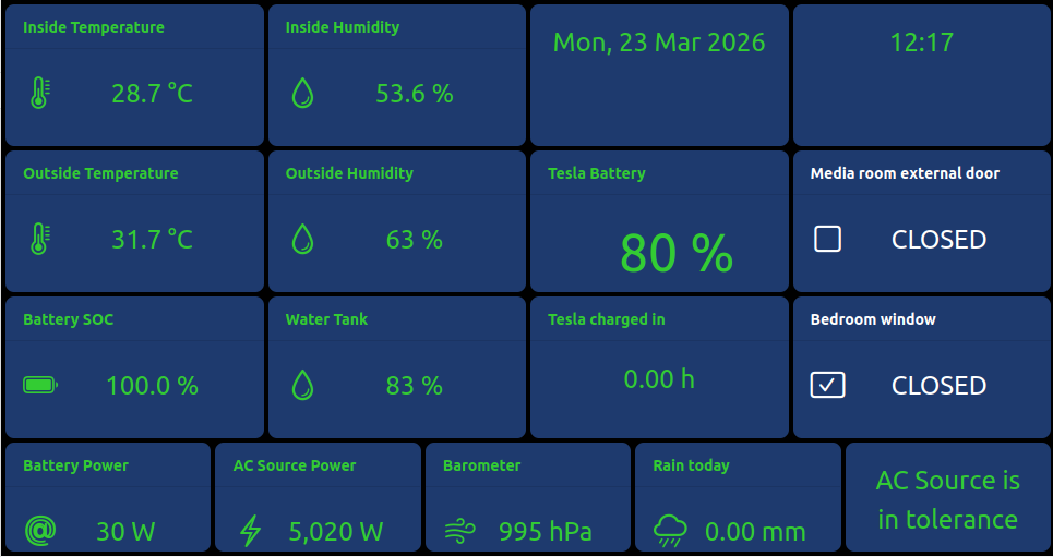

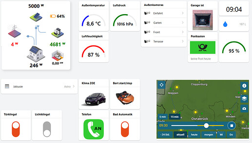

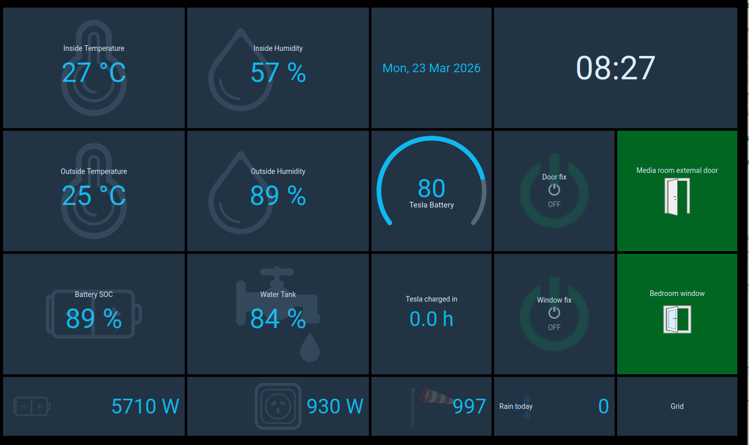

I have decided to ditch HABpanel and go with MainUI. Just started building my first page to replicate my HABpanel. (It/fonts render nicer on the rPi panel)
my first ui panel :slight_smile:
not finished yet; still trying to figure things out.

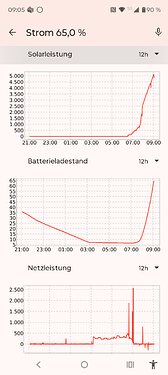

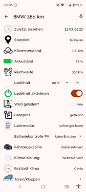

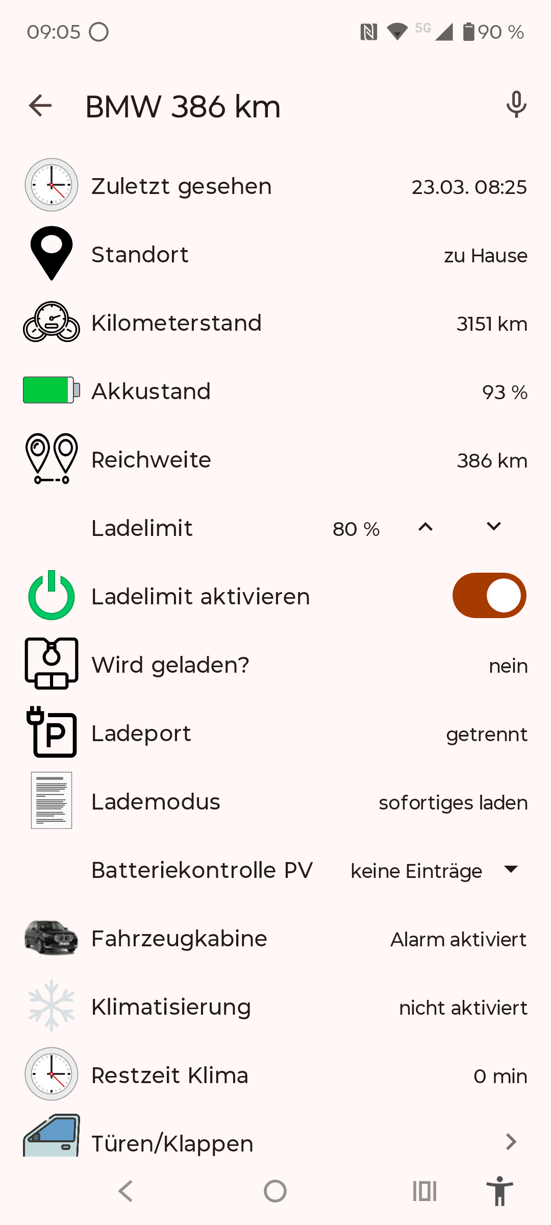

I personally don’t like fancy graphical stuff, so I am using Sitemaps with BasicUI.
A lot of visualized data on a tiny little smartphone display, very easy to create and maintain:

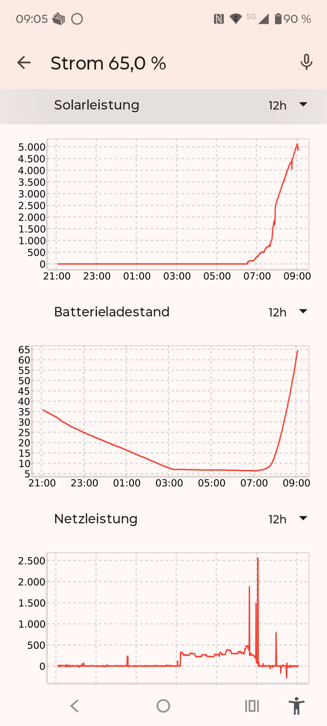

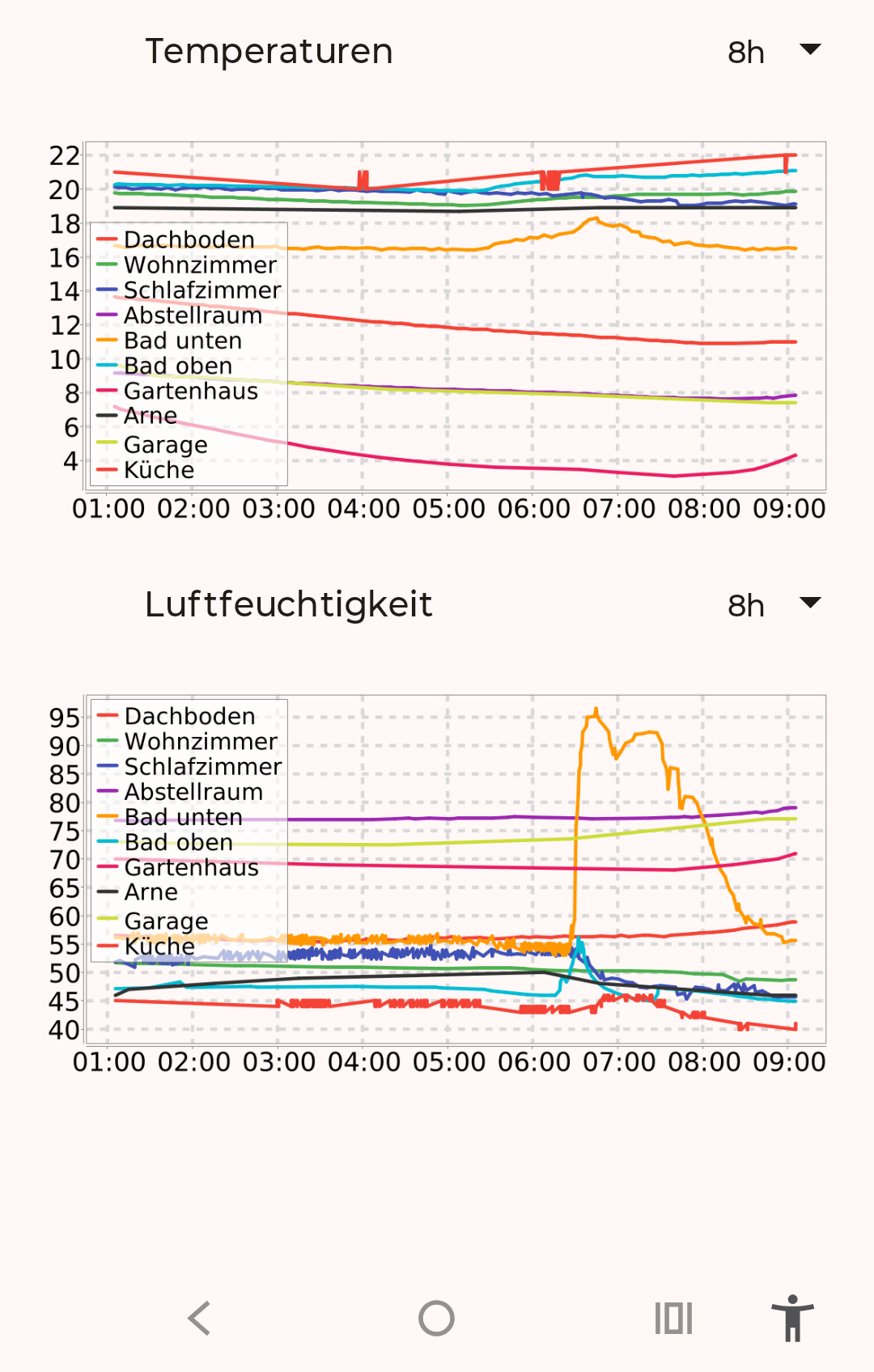

Also Sitemaps are sufficient for some graphs:
And if i need more data on a single graph:

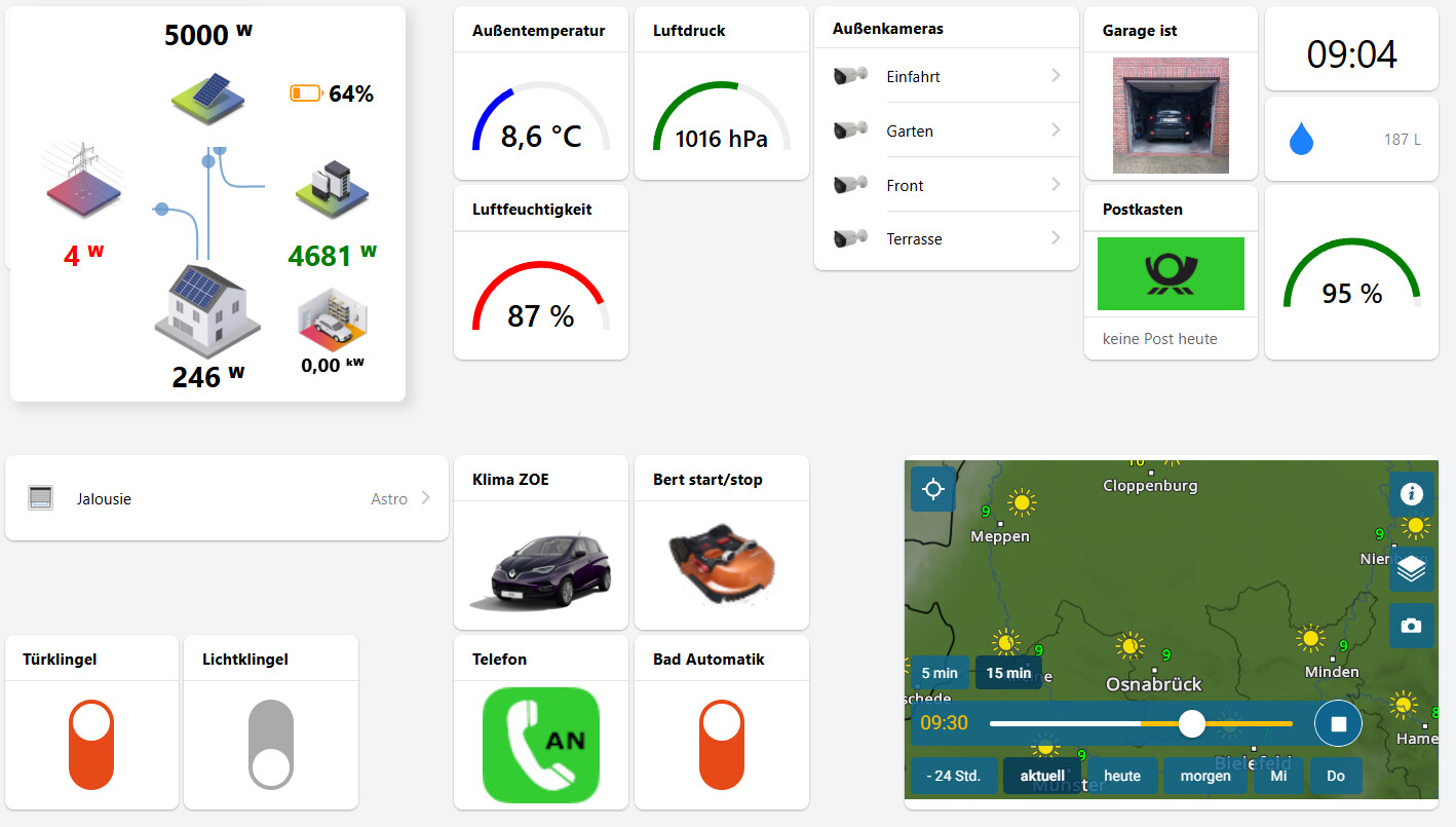

I have one Android tablet on the living room wall to see and control some data, but mostly we are using speech control through Alexa and the Matter binding.

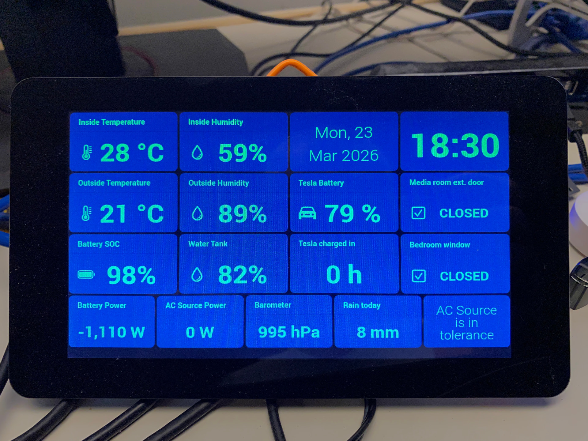

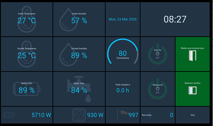

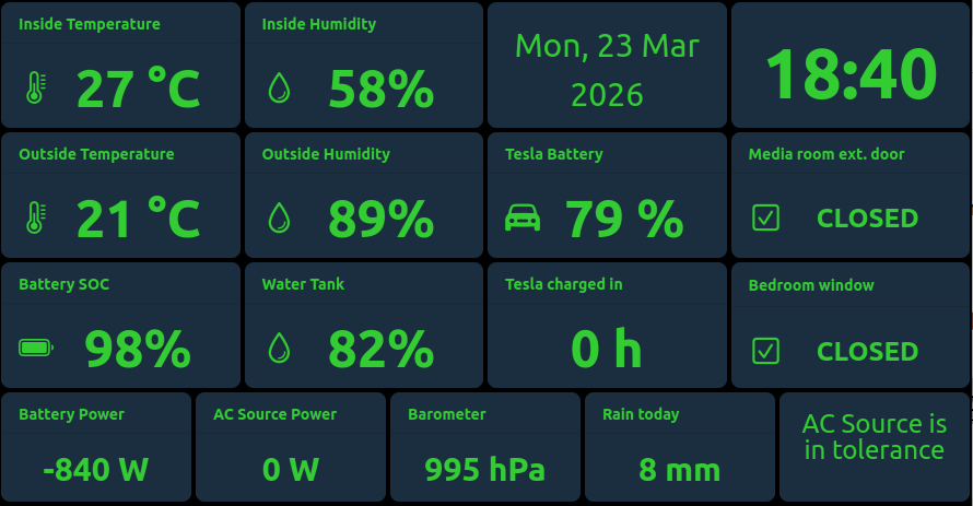

Now my replacement is complete!
Six hours for using this the first time is acceptable :slight_smile:
PC view: (which we do not use)
RPi view
The bold and big is for us oldies (70) to read this from 3 m (10 ft) away :slight_smile:

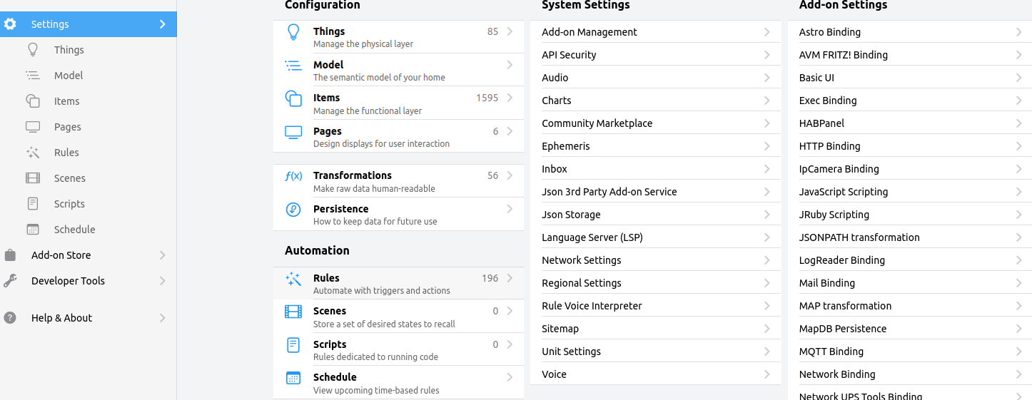

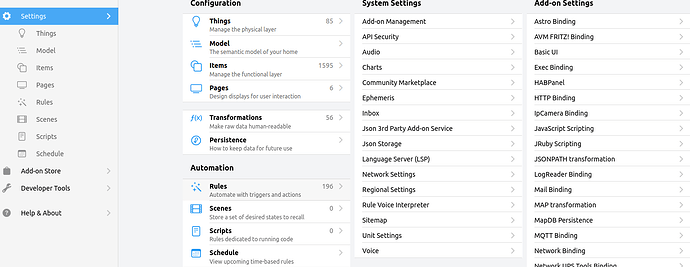

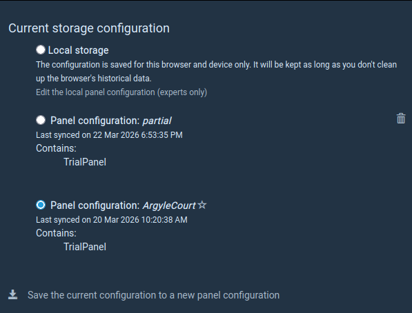

You need to go to http://openhabian:8080/overview/ first in the same browser where you want to run habpanel. Then login to Openhab. If you now call Habpanel you will have the star to configure your Habpanel pages.
