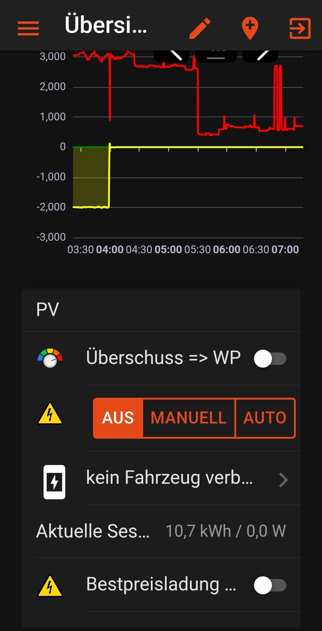

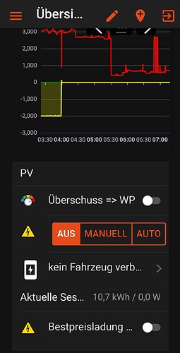

You can use normal Switches with a Mapping.
I am not at my pc at the moment but it should look like this.
Switch mapping=[on=“On”, auto=“Auto”, off=“Off”]
Take a look at the wiki entry on sitemaps.
Keep in Mind: You will have to use a String Item for this (Switch Item is ON or OFF (or uninitialized))
Or you use a Number Item and set up a Mapping like Switch MySwitch mapping=[1=“On”, 2=“Auto”, 0=“Off”], depends on how you bind the item to your Hardware…

I want to control certain devices (groups of devices).
They can be always off, always on, or switched by a rule (auto)
The suggested switch, I use already, but it is too prominent for the use case I have (using too much space).
Having a three state toggle switch would be convenient.
