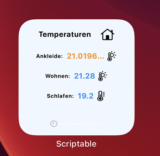

Hi! I’m making a series of widgets using Scriptable, from iOS. Today I have finished my first widget, to show 3 different temperatures.
The widget only needs to be configured with the username and password, to obtain the data. Obviously it can be edited to anyone’s whim, I hope this helps.
I configured the widget in such a way that I could get the data, via myopenhab.org to be able to use it anywhere.
In the next few days I will be uploading more widgets.
I hope someone finds it useful :slight_smile:
Greetings.

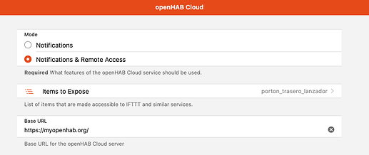

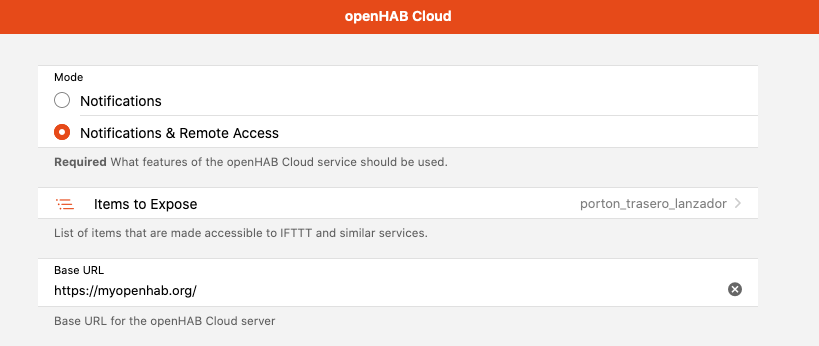

Exactly! Please, check in Configuration → openHAB Cloud, if the Base URL is myopenhab.org as seen in my image. If not, edit the widget code with the url you use. Generally the port that openhab uses to communicate is 443.

Additionally, thanks to your capture, I discovered that I have not set to truncate decimals, among other things. Please check GitHub again for improvements. Thank you very much for helping me improve the widget!

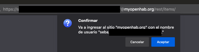

Connect via browser to the url also doesn’t work.
What’s about the encoding? Do I need to encode only the @ in username or do I need to encode the password, too? And if yes which part of it? The complete password or only my special chars in it?

Okay, so the problem may be an authentication.
Yes, you need to encode all the username and password BUT.. (Thanks again to you) I updated the widget so that you simply need to put your username and password normally and the code will encode for you, forget about character encoding and headache :wink:
Please, try with the new code and tell me! BTW first try to conect with the browser so we can rule out future problems.

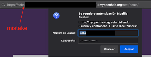

Ok.. there is some success. This was the issue: I got a ! in my password, so I converted this to %21. But it looks like this was wrong. No need to encode the ! .
If I encode the user and password with your script the connection via browser works. BUT I need to log in. There is a pop up log in window. Looks like the credentials are not parsed to the site. Afer I logged in the REST works.

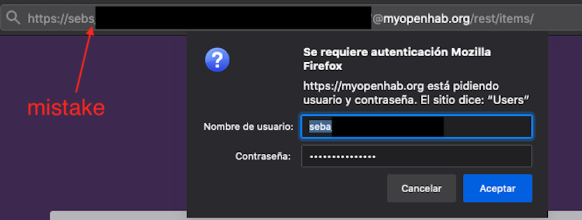

I think the problem is that the credentials are not correct for the site, so it asks for them again.
If I enter my correct credentials in a private tab ..
If I enter my credentials wrong…
I need to enter the credentials again.
So yes, I think it is a problem with the encoding of the username or password.

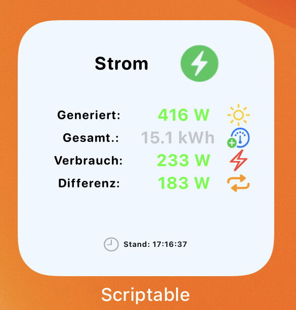

I used your code and changed it a litte bit to show my power consumption and generating. The icons and text color changes depending on the values. I like it.
Took a while because I am not a coder, but now it is working :slight_smile:
