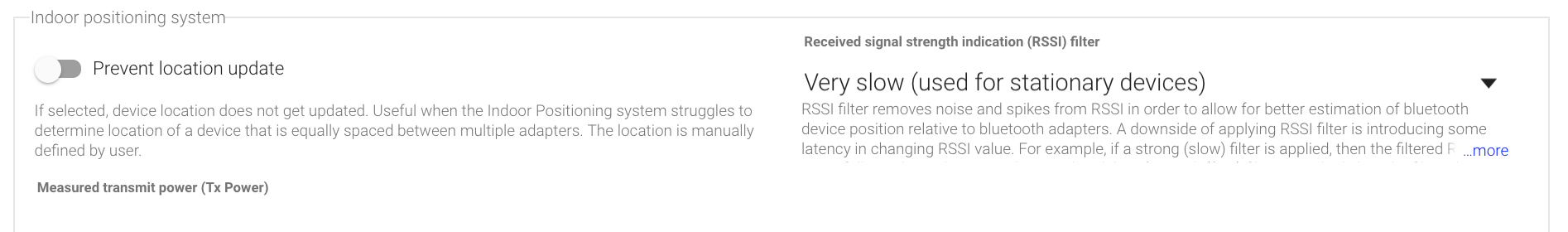

Already jumping at the next features…Estimated distance seems to work somehow, is it normal to your experience, that this has quite a latency (I moved it from right next to my Raspberry a couple of meters away and it took around 4-5 minutes to slowly step up to the final distance) ?
