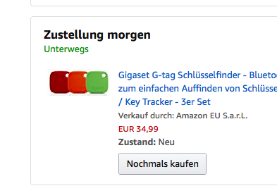

My Bluetooth Devices arrives Tomorrow, the Binding comes @ the right time … first a planned to used a Raspberry to track … but the Binding takes it all in one :slight_smile:

Tomorow my Bluetooth Tags arrives … I think thats the better Solution for Presence and worked better because they all-time visible :slight_smile:

Yes, it is possible.
I’ve got similar keyfob devices, it is working quite well.
