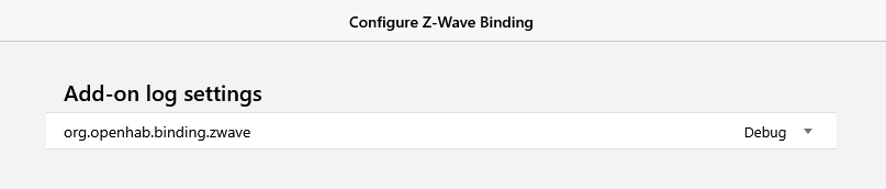

Generally, this is related ZW network congestion. Setting the ZW binding to debug should help diagnostics. The event log and the OH log info level have no useful diagnostic information for ZW. Outside of OH, if you have a Zniffer, that will show actual ZW radio traffic.
This is how I would set the debug option, correct?

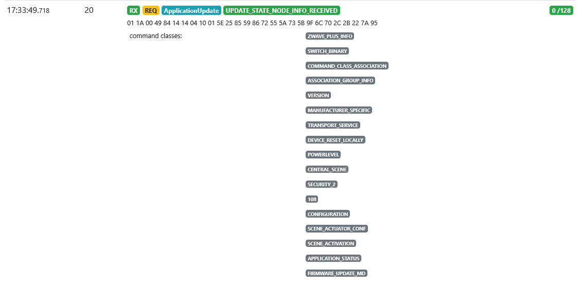

What do I need for a Zwave sniffer? A very long time ago I played around with a Zigbee radio in sniffer mode and hooked it up via serial to my Windows machine and did see ‘stuff’. Is it basically the same thing?
Okay, yeah, I see ‘more’ in the log now:

Seems like the Zooz remote switch is actually working, hmmm

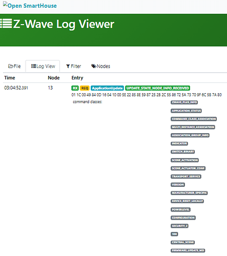

Here’s the debug log for a device zwave:device:5191b78b16:node13 when I flip the switch, it’s state doesn’t update in OPenHAB.
OpenHAB sees it as a “GE 58433/58436 GE Enbrighten Z-Wave Plus Smart Switch”
2026-01-17 03:04:52.391 [DEBUG] [WaveSerialHandler$ZWaveReceiveThread] - Receive Message = 01 1C 00 49 84 0D 16 04 10 00 5E 22 85 8E 59 87 25 2B 2C 55 86 72 5A 73 70 9F 6C 5B 7A 80
2026-01-17 03:04:52.392 [DEBUG] [nal.protocol.ZWaveTransactionManager] - processReceiveMessage input 0<>128 : Message: class=ApplicationUpdate[73], type=Request[0], dest=13, callback=132, payload=84 0D 16 04 10 00 5E 22 85 8E 59 87 25 2B 2C 55 86 72 5A 73 70 9F 6C 5B 7A
2026-01-17 03:04:52.392 [DEBUG] [nal.protocol.ZWaveTransactionManager] - Received msg (0): Message: class=ApplicationUpdate[73], type=Request[0], dest=13, callback=132, payload=84 0D 16 04 10 00 5E 22 85 8E 59 87 25 2B 2C 55 86 72 5A 73 70 9F 6C 5B 7A
2026-01-17 03:04:52.392 [DEBUG] [nal.protocol.ZWaveTransactionManager] - lastTransaction null
2026-01-17 03:04:52.392 [DEBUG] [nal.protocol.ZWaveTransactionManager] - Checking outstanding transactions: 0
2026-01-17 03:04:52.392 [DEBUG] [nal.protocol.ZWaveTransactionManager] - Last transaction: null
2026-01-17 03:04:52.392 [DEBUG] [ve.internal.protocol.ZWaveController] - Incoming Message: Message: class=ApplicationUpdate[73], type=Request[0], dest=13, callback=132, payload=84 0D 16 04 10 00 5E 22 85 8E 59 87 25 2B 2C 55 86 72 5A 73 70 9F 6C 5B 7A
2026-01-17 03:04:52.393 [DEBUG] [essage.ApplicationUpdateMessageClass] - NODE 13: Application update request. Node information received. Transaction null
2026-01-17 03:04:52.393 [DEBUG] [ng.zwave.internal.protocol.ZWaveNode] - NODE 13: resetResendCount initComplete=true isDead=false
2026-01-17 03:04:52.393 [DEBUG] [essage.ApplicationUpdateMessageClass] - NODE 13: Application update - no transaction.
2026-01-17 03:04:52.393 [DEBUG] [nal.protocol.ZWaveTransactionManager] - ZWaveReceiveThread queue empty
2026-01-17 03:04:52.393 [DEBUG] [nal.protocol.ZWaveTransactionManager] - Transaction SendNextMessage 0 out at start. Holdoff false.

2026-01-17 03:04:57.121 [DEBUG] [nal.protocol.ZWaveTransactionManager] - Received msg (0): Message: class=ApplicationCommandHandler[4], type=Request[0], dest=24, callback=0, payload=00 18 0A 32 02 21 32 00 00 01 2C 00 00
2026-01-17 03:04:57.121 [DEBUG] [nal.protocol.ZWaveTransactionManager] - lastTransaction null

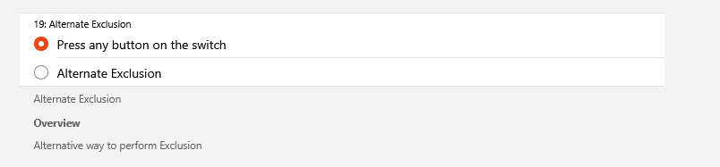

In this case the device is sending a non-sensical message and I don’t see why. Using the Zwave log viewer it is sending all the supported command classes, not a simple basic command.
There is not a lot of documentation in the ZW db about the parameters, but the alternate exclusion parameter (19) looks odd. Maybe when you change the switch locally, it is trying to exclude itself. I’d switch that option and try again. Also may want to review all the parameters in your manual.

I wasn’t suggesting that. Just check the parameter 19 because of the type of message in your log was wrong.

Thats was I was thinking. I’m not sure what alternate Exclusion is, but it seems to send a bad command with the press any button on the switch
I checked the setting on a light switch that is properly updating and it’s the same. I could try swapping the setting to see what it does, but supposedly, that’s the default setting according to some very limited documentation on the subject.

But here’s the log from a different light switch zwave:device:5191b78b16:node20 with a similar problem:
2026-01-17 17:33:49.718 [DEBUG] [nal.protocol.ZWaveTransactionManager] - processReceiveMessage input 0<>128 : Message: class=ApplicationUpdate[73], type=Request[0], dest=20, callback=132, payload=84 14 14 04 10 01 5E 25 85 59 86 72 55 5A 73 5B 9F 6C 70 2C 2B 22 7A
2026-01-17 17:33:49.718 [DEBUG] [nal.protocol.ZWaveTransactionManager] - Received msg (0): Message: class=ApplicationUpdate[73], type=Request[0], dest=20, callback=132, payload=84 14 14 04 10 01 5E 25 85 59 86 72 55 5A 73 5B 9F 6C 70 2C 2B 22 7A
2026-01-17 17:33:49.718 [DEBUG] [nal.protocol.ZWaveTransactionManager] - lastTransaction null
2026-01-17 17:33:49.718 [DEBUG] [nal.protocol.ZWaveTransactionManager] - Checking outstanding transactions: 0
2026-01-17 17:33:49.718 [DEBUG] [nal.protocol.ZWaveTransactionManager] - Last transaction: null
2026-01-17 17:33:49.719 [DEBUG] [ve.internal.protocol.ZWaveController] - Incoming Message: Message: class=ApplicationUpdate[73], type=Request[0], dest=20, callback=132, payload=84 14 14 04 10 01 5E 25 85 59 86 72 55 5A 73 5B 9F 6C 70 2C 2B 22 7A
2026-01-17 17:33:49.719 [DEBUG] [essage.ApplicationUpdateMessageClass] - NODE 20: Application update request. Node information received. Transaction null
2026-01-17 17:33:49.719 [DEBUG] [ng.zwave.internal.protocol.ZWaveNode] - NODE 20: resetResendCount initComplete=true isDead=false
2026-01-17 17:33:49.719 [DEBUG] [essage.ApplicationUpdateMessageClass] - NODE 20: Application update - no transaction.
2026-01-17 17:33:49.719 [DEBUG] [nal.protocol.ZWaveTransactionManager] - ZWaveReceiveThread queue empty
2026-01-17 17:33:49.719 [DEBUG] [nal.protocol.ZWaveTransactionManager] - Transaction SendNextMessage 0 out at start. Holdoff false.
