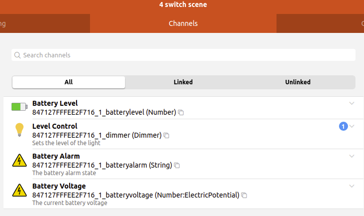

Progress. I was pressing the wrong button for pairing. It pairs now, but none of the switch channels show. I remember reading about this somewhere, so I need to do some more digging.
I’m not sure how this device works, but there is one switch channel showing here (ie the level control / dimmer channel) - I guess there aren’t more lower down the list. It might be that this device effectively provides a scene trigger rather than individual switch/dimmer channels which might require a custom device definition - hopefully searching around will provide more information.
Okay, after reading up on other threads, this switch has modes that can be set. It can be put into dimmer mode, or four-switch mode. Mine may just need to be configured, and it seems that most are configuring it with the Tuya gateway first.
