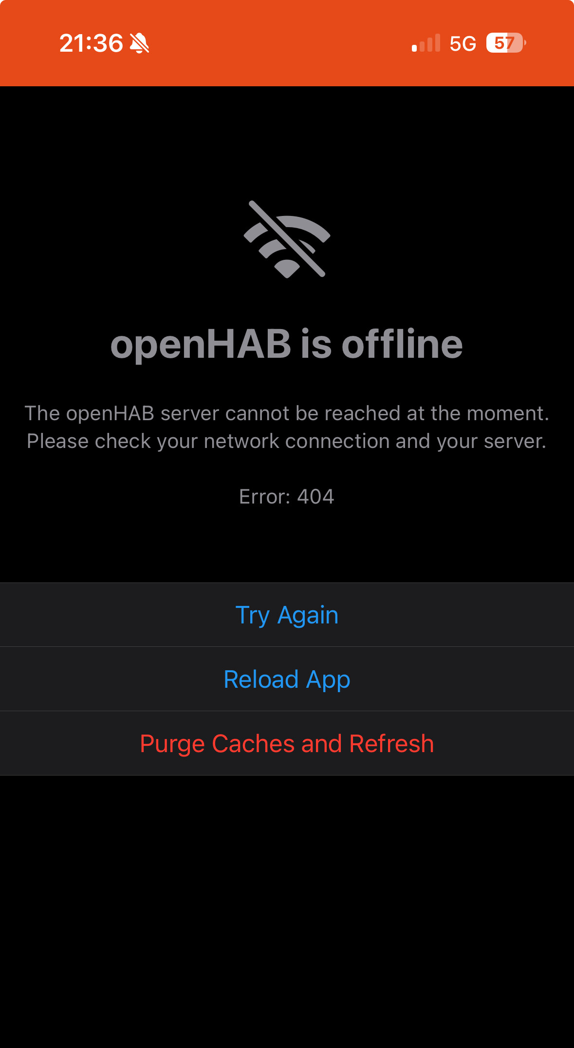

i want to access my openhab instance from the internet with authentication with oauth-proxy and keycloak.
This is my nginx configuration:
server {
# Server config
listen 443 ssl;
server_name openhab.domain.de www.openhab.domain.de;
# SSL Certs
ssl_certificate /etc/letsencrypt/live/openhab.domain.de/fullchain.pem;
ssl_certificate_key /etc/letsencrypt/live/openhab.domain.de/privkey.pem;
#include ssl/ssl.conf;
location /oauth2/ {
proxy_pass http://auth.domain.de:1080;
proxy_set_header Host $host;
proxy_set_header X-Real-IP $remote_addr;
proxy_set_header X-Scheme $scheme;
proxy_set_header X-Auth-Request-Redirect $request_uri;
# or, if you are handling multiple domains:
#proxy_set_header X-Auth-Request-Redirect $scheme://$host$request_uri;
location /oauth2/auth {
# nginx auth_request includes headers but not body
proxy_set_header Content-Length "";
proxy_pass_request_body off;
#set $args $args&allowed_groups=/ldap/openhab;
location / {
proxy_pass https://192.168.10.165:8443/$request_uri;
auth_request /oauth2/auth;
error_page 401 = /oauth2/sign_in?rd=https://192.168.10.165:8443;
#error_page 401 = /oauth2/start;
# pass information via X-User and X-Email headers to backend,
# requires running with --set-xauthrequest flag
auth_request_set $user $upstream_http_x_auth_request_user;
auth_request_set $email $upstream_http_x_auth_request_email;
proxy_set_header X-User $user;
proxy_set_header X-Email $email;
# if you enabled --pass-access-token, this will pass the token to the backend
auth_request_set $token $upstream_http_x_auth_request_access_token;
proxy_set_header X-Access-Token $token;
# if you enabled --cookie-refresh, this is needed for it to work with auth_request
auth_request_set $auth_cookie $upstream_http_set_cookie;
add_header Set-Cookie $auth_cookie;
# When using the --set-authorization-header flag, some provider's cookies can exceed the 4kb
# limit and so the OAuth2 Proxy splits these into multiple parts.
# Nginx normally only copies the first `Set-Cookie` header from the auth_request to the response,
# so if your cookies are larger than 4kb, you will need to extract additional cookies manually.
auth_request_set $auth_cookie_name_upstream_1 $upstream_cookie_auth_cookie_name_1;
# Extract the Cookie attributes from the first Set-Cookie header and append them
# to the second part ($upstream_cookie_* variables only contain the raw cookie content)
if ($auth_cookie ~* "(; .*)") {
set $auth_cookie_name_0 $auth_cookie;
set $auth_cookie_name_1 "auth_cookie_name_1=$auth_cookie_name_upstream_1$1";
# Send both Set-Cookie headers now if there was a second part
if ($auth_cookie_name_upstream_1) {
add_header Set-Cookie $auth_cookie_name_0;
add_header Set-Cookie $auth_cookie_name_1;
proxy_set_header X-Forwarded-For $proxy_add_x_forwarded_for;
Thanks for your help in advance,
Alex
