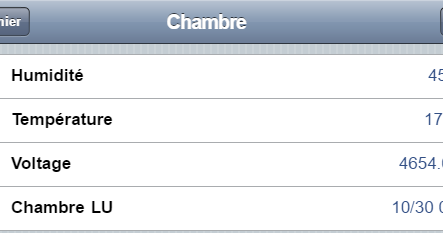

Regarding the DHT11 here is an example:
https://github.com/1technophile/433toMQTTto433_ESP8266/issues/13
You could begin by adding this as a first step.
The main principle is to add an extra function to handle the DHT11 and or the Servo and to call this function when needed.
Regarding the DHT11 maybe to call it in the loop every x seconds by using millis function and make it send MQTT after reading by sendMQTT(subjectDHT_HUM,String(HUMvalue));
