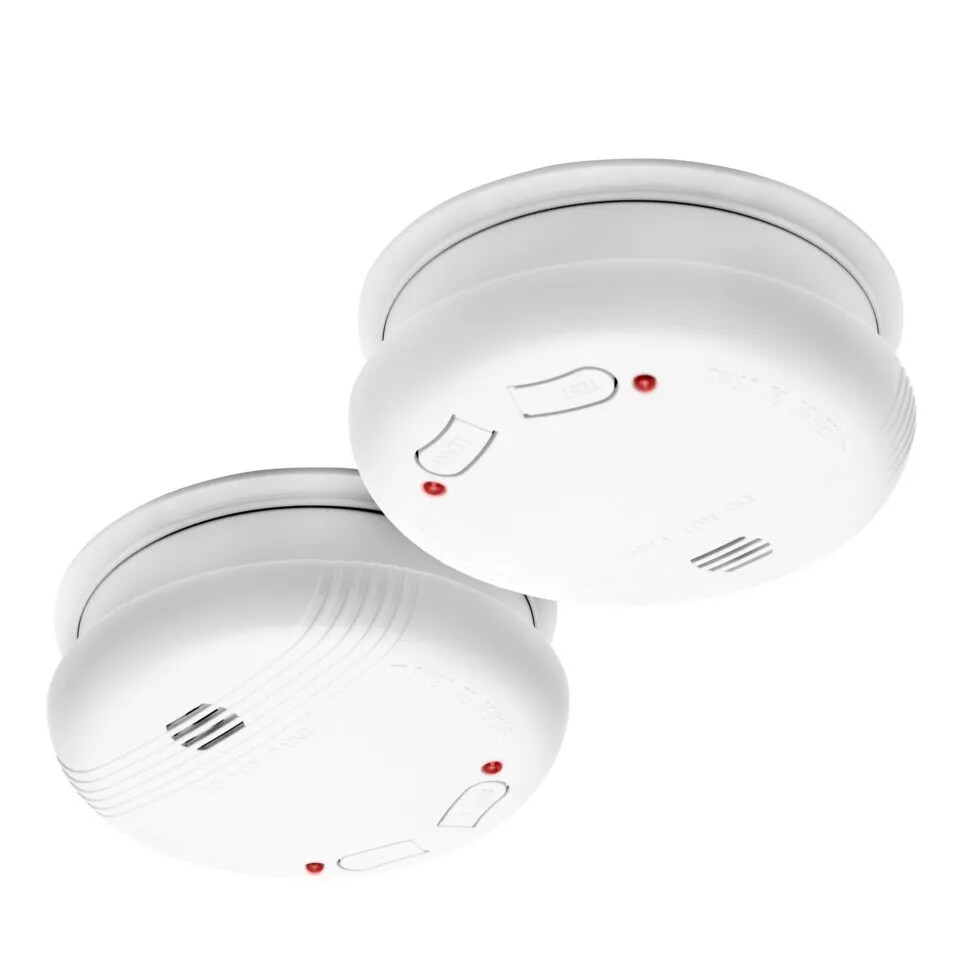

I’m trying to connect a new smokedetector from luxorparts
This seems to be a rebrand of KD101 and RM174RF. But I cant figure how to include them to Openhab.

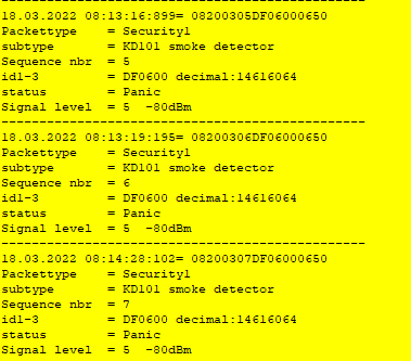

With RFXmngr (windows) I was able to pick this up when pressing TEST. But nothing comes up in Openhab when rfxtrx is connected back to Rpi
At first it even came up as
But I cant find subtype RM17RF under Security1 Sensor

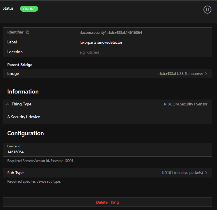

I was able to include after a openhab reboot, smokedetedector reboot, and TEST’ed the smokedetector close to the RFXtrx-module
Added new thing 'rfxcom:security1:rfxtrx433xl:14616064' to inbox.
Discovery Result with UID 'rfxcom:security1:rfxtrx433xl:14616064' has been added.

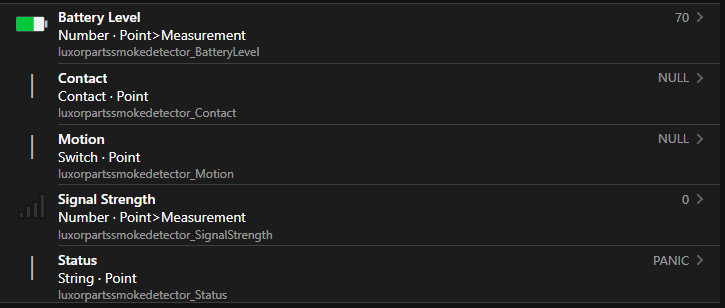

I can send a PANIC command to trigger the Alarm for few seconds. And i recieve a PANIC-state when pressing TEST on the smokedetector
I get a PANIC-state when testing with Smoke Detector Tester
But only if luxorpartssmokedetector_Status is not already PANIC . I was hoping to get a OFF-state when the alarm was turned off. But it seems like I have to make an rule to Reset the luxorpartssmokedetector_Status to null
