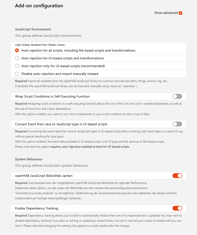

I found and disabled the two options. Openhap was restarted, but the behavior remained the same.
Here a screenshot of the settings:

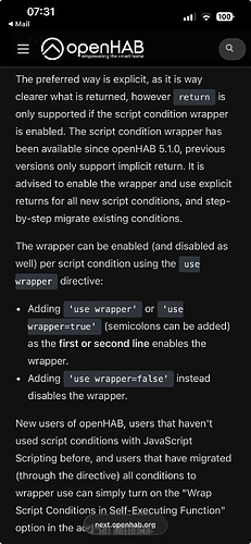

I have never said it’s undocumented for Script Conditions. It is however undocumented for Script Actions. FYI this is how the docs look like:
(JavaScript Scripting - Automation | openHAB)
