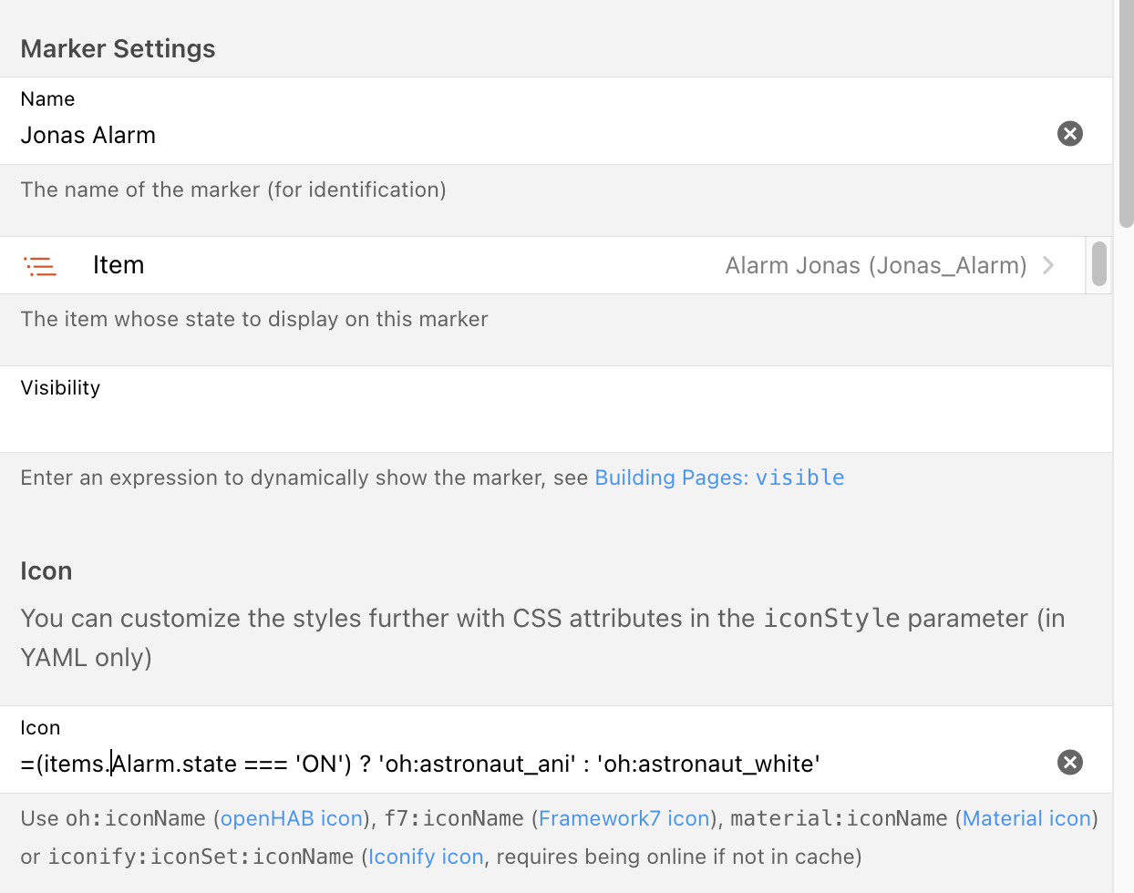

Will that expression work everywhere, ie. also in a floorplan marker setting?
Yes, anywhere you can enter a “javascript” expression that starts with a =. For ternary situation it isn’t very different I guess. You could at least convert items.Alarm.state to @'Alarm'.
Great, that makes a lot of my expressions much easier to read.
