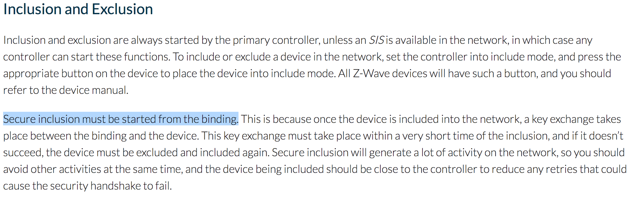

…The result was troubling. I found a topic on their forum, and started reading. There, plain as day, was some miraculous individual making the statement below:
The button on the Z-Stick is great for quick exclusions, but only performs regular, non-encrypted inclusions.
If your device supports the S0 Security CC, make performing inclusions over USB a habit.
You are supposed to pair inclusions over USB.
YOU ARE SUPPOSED TO PAIR INCLUSIONS OVER USB.
… It worked perfectly.
I cannot believe this is not mentioned anywhere? Where can we make this clear so that no one will ever have this problem again?
It’s always good to read the binding documentation :wink:
Yeah. I would have read this when I started with secure inclusion, but I think it just never jumped out at me until it was put in terms like “over USB”.
