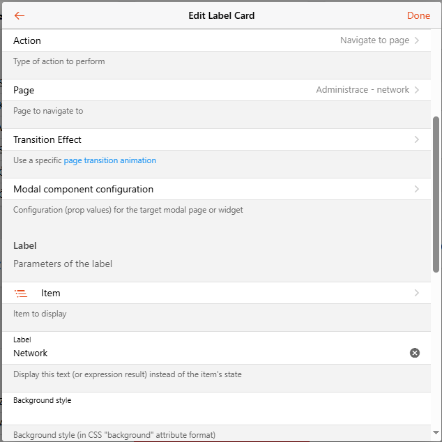

I use those Label card widgets for simple page navigation. You don’t need to set the Item, but rather provide label as ā€œbuttonā€ text and define action for navigation.
e.g. like this for navigation to network overview page:
component: oh-label-card
  action: navigate
  actionPage: page:pageAdminNetworkOverview
  label: Network

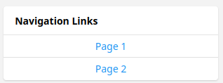

Sure, you can do this too. Again, anything with access to the actions system can do these navigation links. In this case you can take advantage of the fact that a basic oh-list-item also has oh actions. So, you’ll just want to use an oh-list-card and add a List item to the card’s list. When you configure that item you can give it any text you want, assign a navigation action and select the option that styles it like a button. Because it’s a list you can even do this as many times as you want for different pages. This card below was also configured entirely with the UI:
Clicking on the ā€œNavigation linksā€ header produces no results, but clicking either of the buttons below that navigates to different pages.
