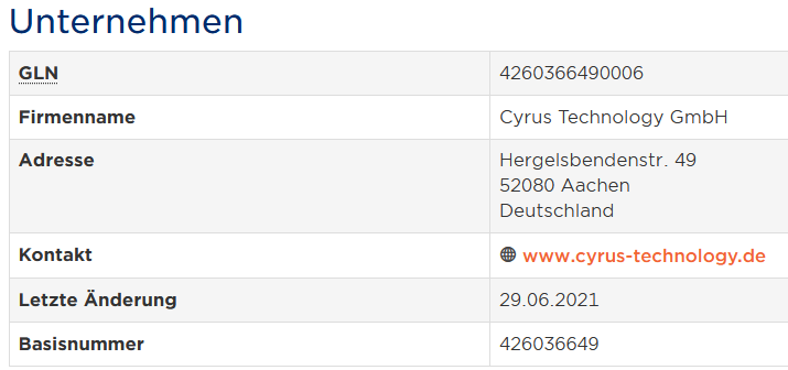

EAN: 4260366490433
According to www.gepir.de:
Why not ask the suspected manufacturer? :slight_smile:
I was on that website, but because I didn’t find anything about Z-Wave products I thought it’s another company with the same name :grimacing:

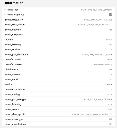

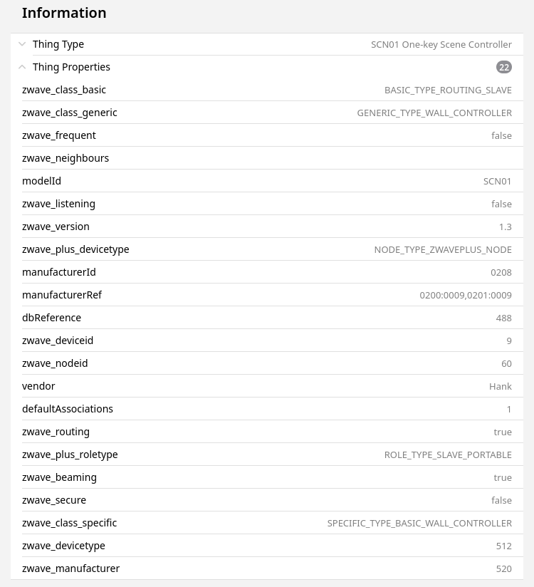

The
arrived today. And on its back it identified itself as HKZW-SCN1. It was not really a surprise then that the inclusion worked flawlessly and OH identified the device with the database entries that already exist (OH 3.3 release):
