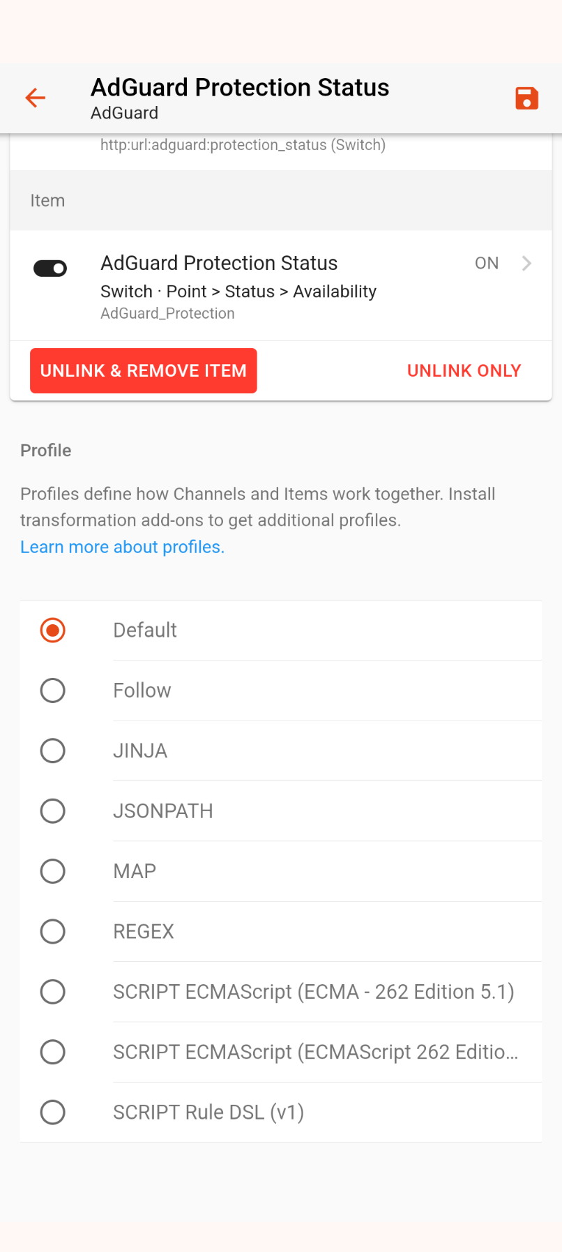

A profile lives on the Item channel link. It will intercept updates coming from the channel and modify them before they get to the Item. It will intercept commands from the Item and modify them before they get to the channel. The sorts of things a profile can do includes:
  • detect single press, double press, long press of buttons
  • convert a sensor reading to on/off with hysteresis (e.g. for controlling an AC)
  • send a command to a second channel when an Item updates from a second channel
  • take a timestamp when an event or command is received at an Item through a channel
  • apply a transformation.
The key is that a profile exists between a channel and an item. If you just have an Item, a profile cannot be used because there is no link.

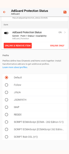

To apply a profile navigate to the Thing Channel and click on the link. At the bottom you can apply a profile. You can also get to the link from the Item’s page.
Only those profiles which make sense based on the Item type will be shown (e.g. you won’t see the timestamp profile unless the Item type is DateTime).
Selecting one of the profiles will present the options available for that profile, since each has different options.
Most of the profiles you see above are script as each automation add-on is listed separately instead of just one Script transform being shown.

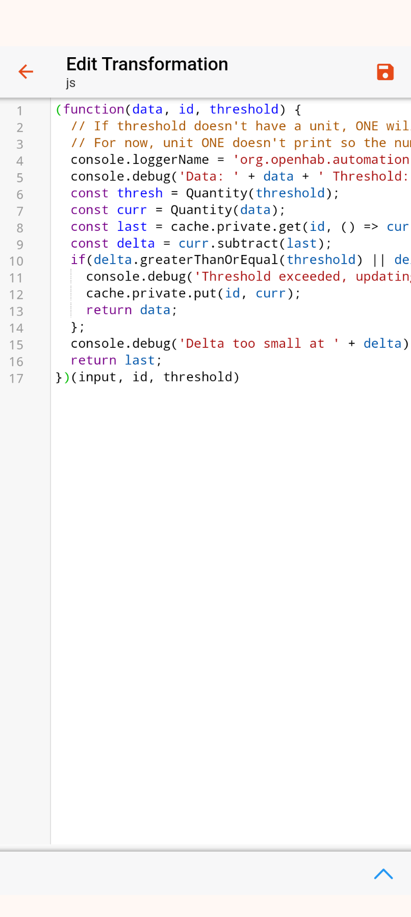

A JS Scripting transformation example:
Full text:
(function(data, id, threshold) {
  // If threshold doesn't have a unit, ONE will be assumed
  // For now, unit ONE doesn't print so the number will be returned without units
  console.loggerName = 'org.openhab.automation.transformation.filter.'+id;
  console.debug('Data: ' + data + ' Threshold: ' + threshold);
  const thresh = Quantity(threshold);
  const curr = Quantity(data);
  const last = cache.private.get(id, () => curr);
  const delta = curr.subtract(last);
  if(delta.greaterThanOrEqual(threshold) || delta.lessThanOrEqual(thresh.multiply(-1))) {
    console.debug('Threshold exceeded, updating item with ' + curr);
    cache.private.put(id, curr);
    return data;
  console.debug('Delta too small at ' + delta);
  return last;
})(input, id, threshold)
In the UI, you refer to a managed transformation by ID. In some places you can select a transformation through a dialog (e.g. when using a transform profile). when a dialog is not available, you use the transformation ID. The ID is shown on each entry at Settings → Transformations and there is a convenient little icon to copy the ID from there.
