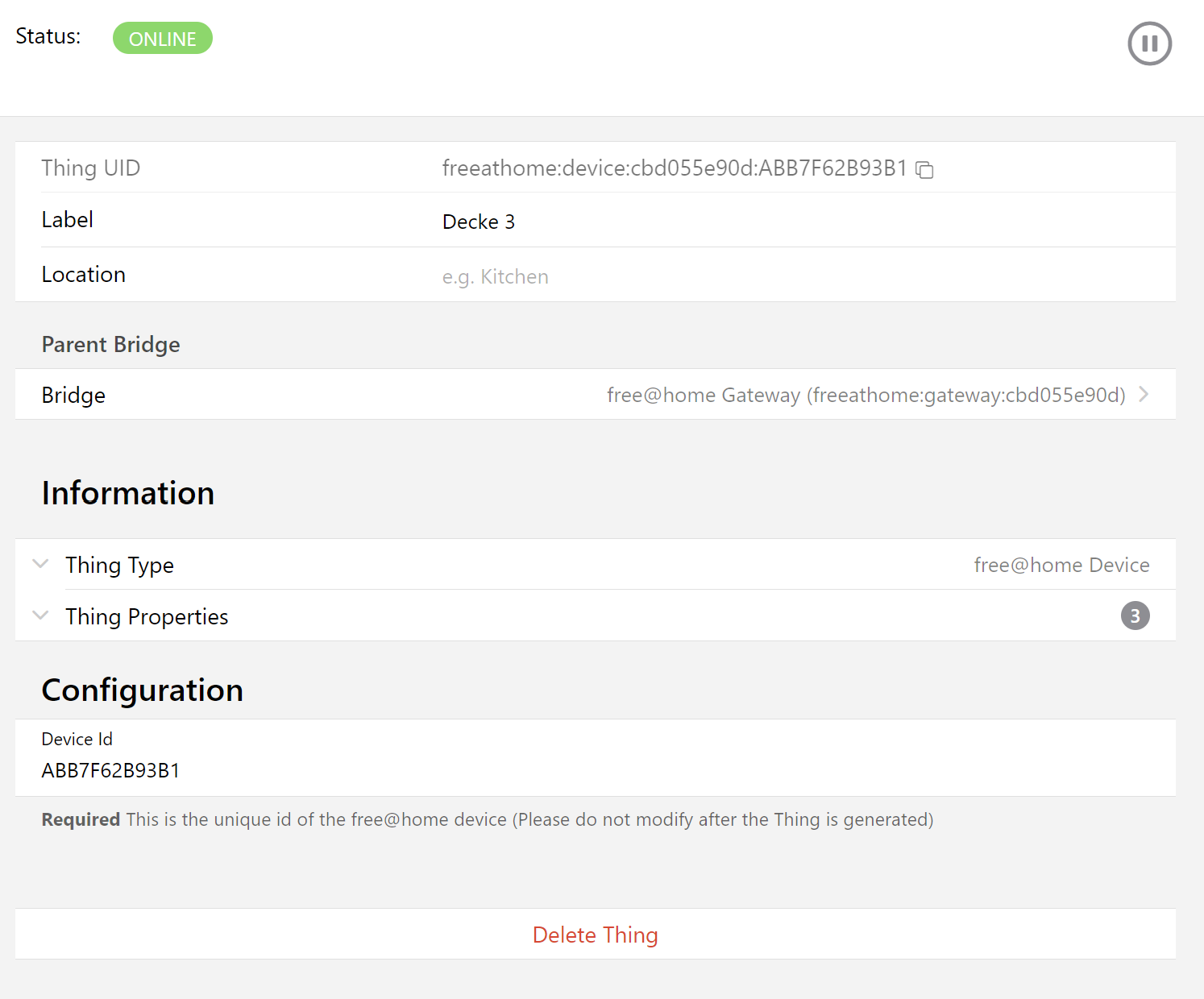

freeAtHome_Gateway
The gateway is online, so the next step would be to add things. Did you try it?
I can’t help you with the warning, but in my opinion you can ignore it for now. We can investigate that later.
Try to add some Busch-Jäger Things.

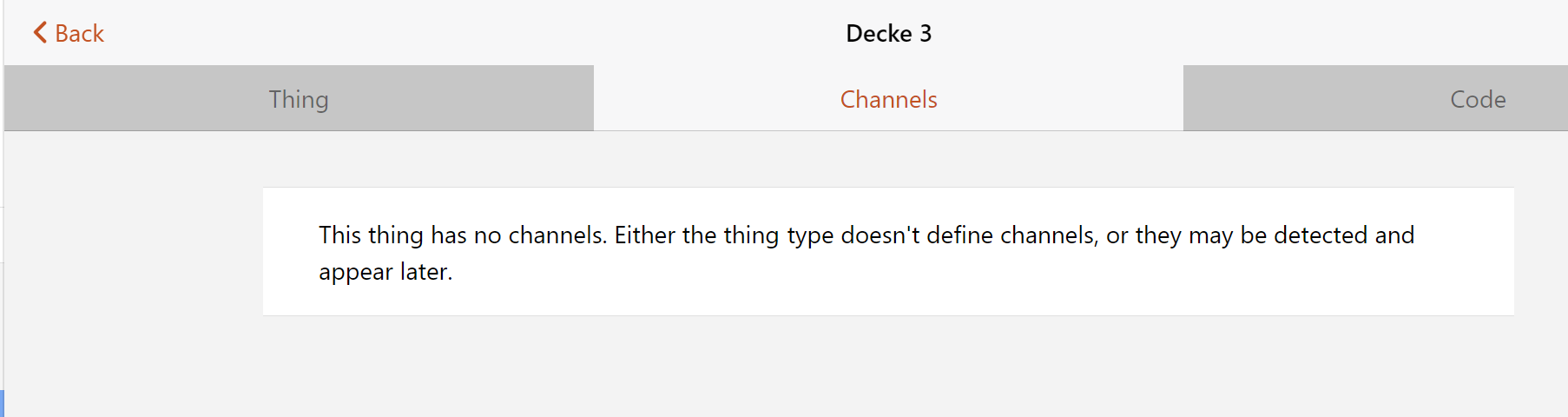

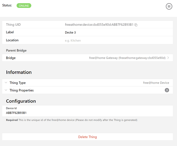

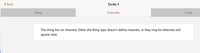

Next, I created a dimmer switch from the inbox as a thing.
freeAtHome_Dimmer_Decke_3
Unfortunately, I cannot select any channels for this thing to add a link.
freeAtHome_Dimmer_Decke_3_no_channels
This is the case with some things, but not with others. What could be my fault?

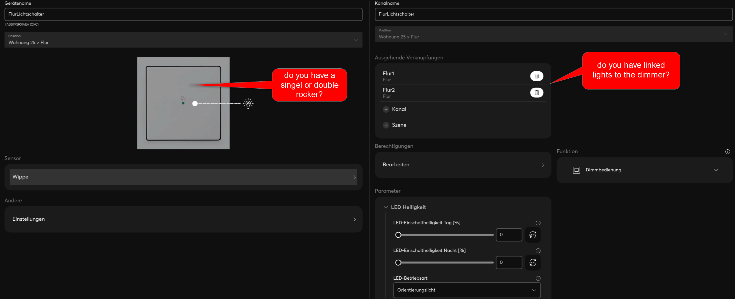

@freeET I just tried it, and it seems that it works.

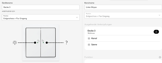

but lets compare the dimmer within the Busch Jäger system:

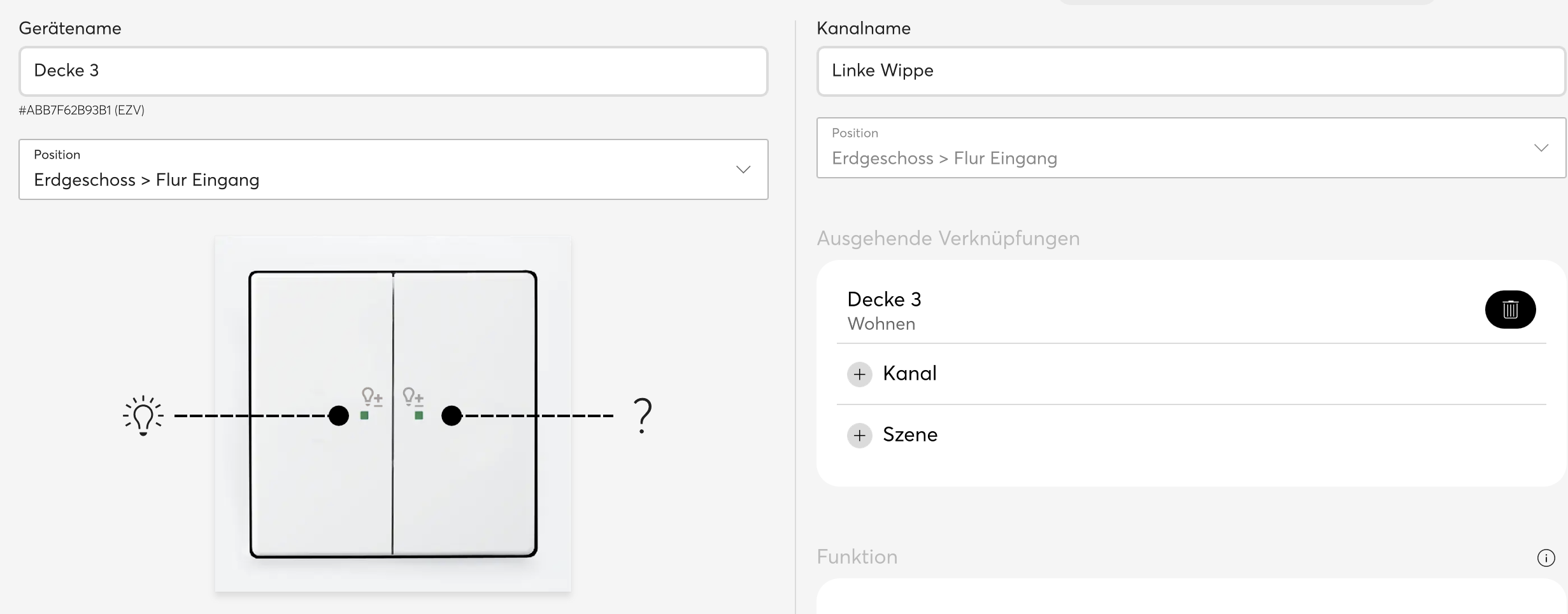

@ML1982 Thank you for your patience. This is what i have:
Wohnzimmer Decke 3
The right-hand switch is intentionally not yet assigned. We want to use it to dim another light later.
I think this is a bug in the binding.
I sounds similar to this one:
https://github.com/openhab/openhab-addons/issues/17354
I think the best would be for you to open your own GitHub ticket for your issue.
