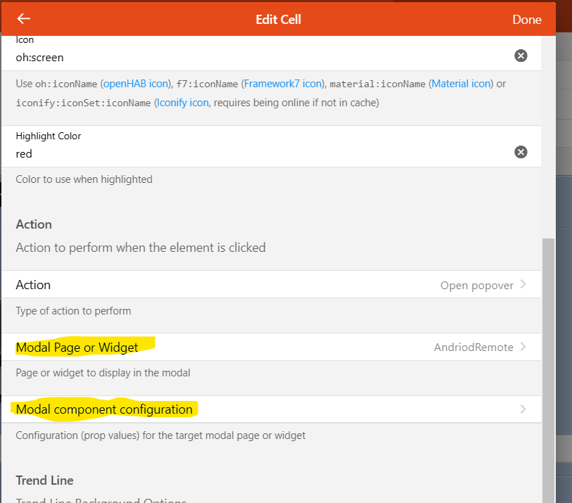

I have a custom widget (widgetA) that can open another custom widget (widgetB) in a popover.
I’d like to be able to set widgetB’s props from WidgetA’s props screen
This can be done in the built in oh-cell widgets but I cant work out how to replicate this with a custom widget.

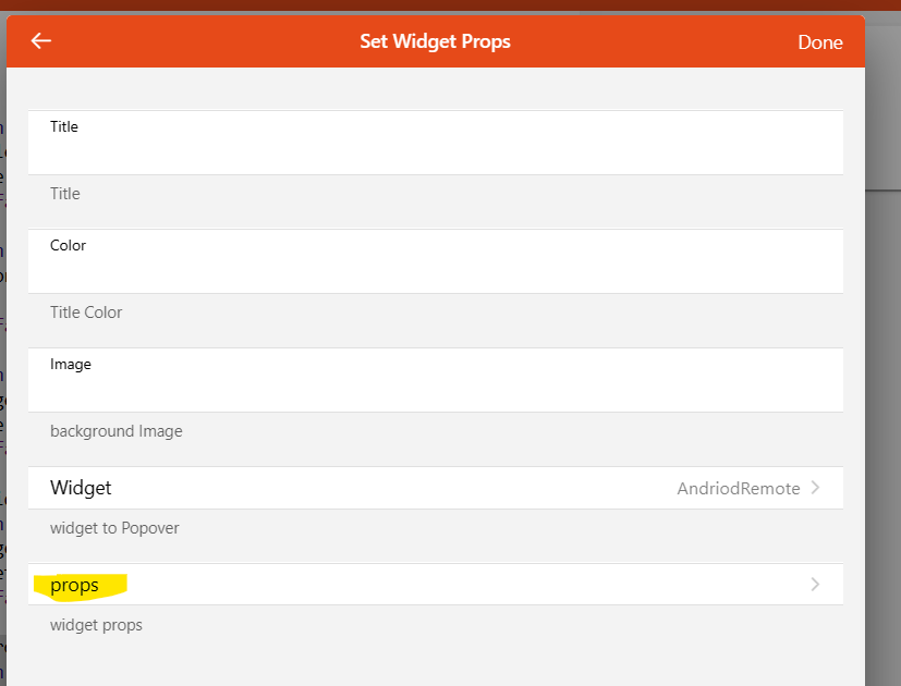

What I would like to do is have a similar prop that will display the props of the selected widgetB and set them.
The closest I’ve been able to get is the below where I set the context to props which does open a model window but its blank.
I cant work out how to reference the selected widgetB’s props.
    - context: props
      description: widget props
      label: props
      required: false
      type: TEXT
I assume I’m missing a lot as I think I would need some sort of prop array?
Does anyone have any ideas?

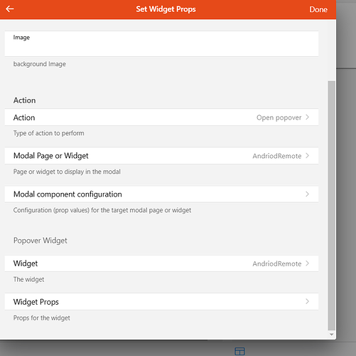

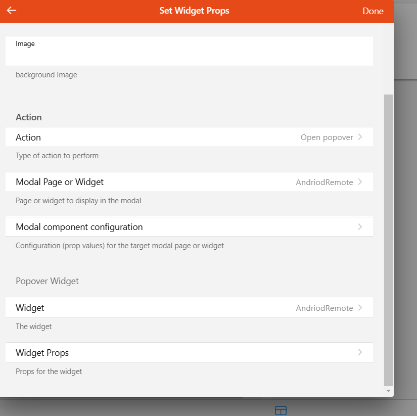

One thing though, I tried adding the Action PropertyGroup. I need to read up more about this so don’t worry too much about it but it’s strange.
It looks to display correctly and I can select an Action but once I select an action it displays additional props like below but they don’t work ( I can select a widget but the Component Config window remains blank)
The selected action doesn’t actually work either (Nothing happens when i click)
With the Action set as Pop over
My code is below just in case you can see a problem but thankyou again. I have got further than I have on my own.

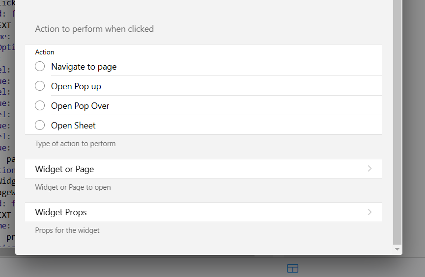

Just to put this thread to bed,
I was unable to find everything I needed about the Action property Group.
Specifically accessing the widget props via the Actions Model Component Configuration. It was always blank.
I did find other community posts that had the same problem but there was no solution that i could find.
Considering the Solution above provided by Yannick and the fact that I only really need a pop over or page Action I have decided to just make a simple actions prop with just the options I needed.
This works well enough for me. Thank you again to Yannick for the Solution.
The code:
uid: LaunchCell
tags: []
props:
  parameters:
    - description: Title
      label: Title
      required: false
      type: TEXT
    - description: Title Color
      label: Color
      required: false
      type: TEXT
    - description: background Image
      label: Image
      required: false
      type: TEXT
    - description: Type of action to perform
      label: Action
      required: false
      type: TEXT
      groupName: widget
      limitToOptions: true
      options:
        - label: Navigate to page
          value: navigate
        - label: Open Pop up
          value: popup
        - label: Open Pop Over
          value: popover
        - label: Open Sheet
          value: sheet
    - context: pagewidget
      description: Widget or Page to open
      label: Widget or Page
      required: false
      type: TEXT
      groupName: widget
    - context: props
      description: Props for the widget
      label: Widget Props
      required: false
      type: TEXT
      groupName: widget
  parameterGroups:
    - name: widget
      description: Action to perform when clicked
timestamp: Mar 17, 2023, 9:06:36 PM
component: f7-card
  style:
    background-image: ="url("+props.Image+")"
    background-position: center
    background-size: cover
    border: 2px
    border-radius: 15px
    border-style: outset
    height: 120px
  default:
    - component: oh-link
        action: = props.ClickAction
        actionPage: = props.PageWidget
        actionModal: = props.PageWidget
        actionModalConfig: =props.Widget_props
        style:
          border-radius: inherit
          height: 100%
          width: 100%
