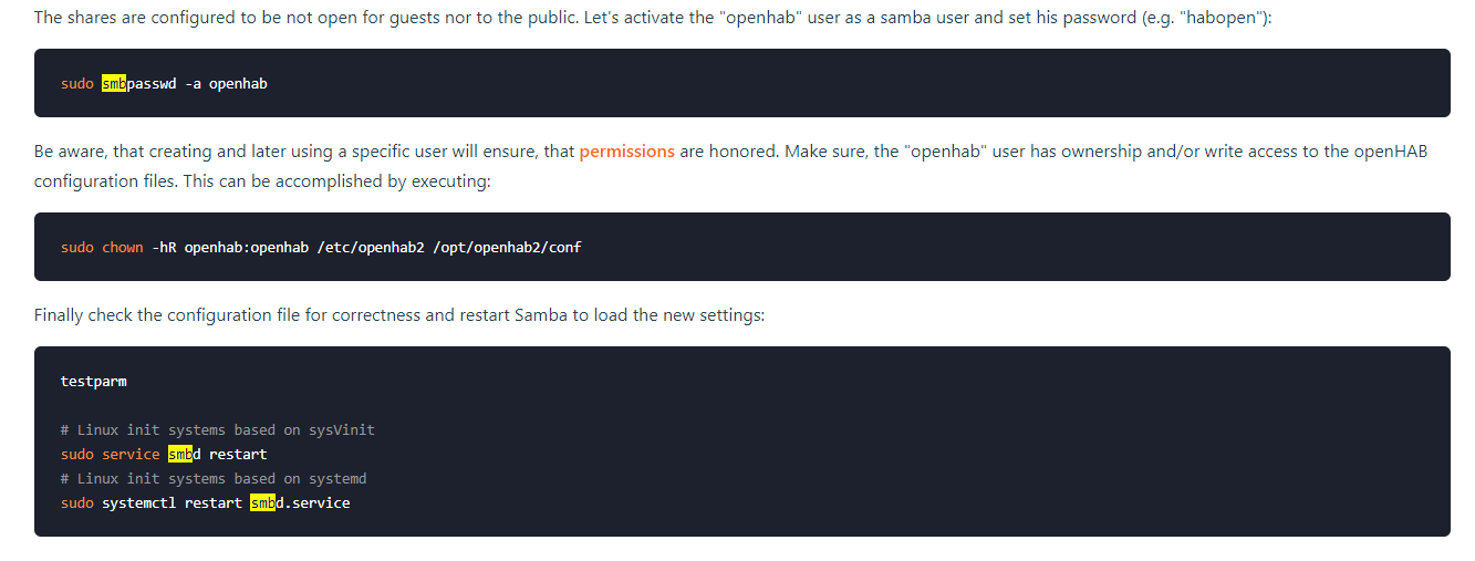

Which user and password is supposed to be used through SMB ? The shares are there, but I cant get it to work using the default openhabian/openhabian.
(I´m getting rather annoyed with these linux creditials)
You have to set up the user/pwd first:
Since you are currently transferring OH and you struggle with the credentials I would suggest you use openhabian-config (openHABian | openHAB) since this takes care about the SMB shares automatically.
I already did that, (I use openhabian). And I set a new password for samba through openhabian-config.. Still I can not enter the shares.
