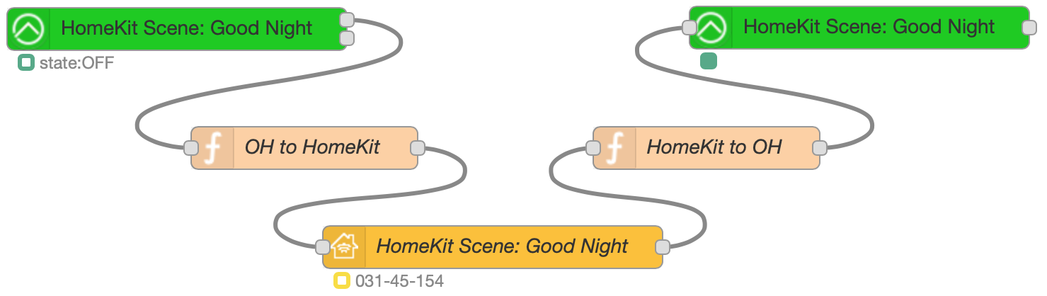

then I added some nodes in Node-RED:
OH to HomeKit function node reads as follows:
if (msg.payload == "ON") {
msg.payload = {
"On": true
} else {
msg.payload = {
"On": false
return msg;
And the code in the HomeKit to OH function node reads as follows:
if (msg.hap.context !== undefined ) {
if (msg.payload.On === false){
msg.payload = "OFF";
} else if(msg.payload.On === true) {
msg.payload = "ON";
return msg;
Deploy the changes in Node-RED and restart the nodered process to expose the new Switch item to HomeKit. if on Linux-like OS, type:
$ sudo systemctl restart nodered
Now your switch item appears in Apple Home. You can now include this switch to your “Good Night” scene. It will toggle on when the scene is activated, and it will turn off when the scene is deactivated.
I recommend to remove the newly discovered switch from the favorites to avoid using it by accident in Apple Home.
