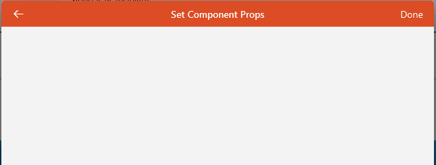

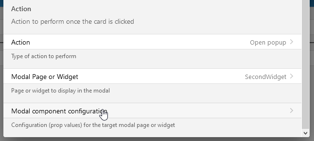

One thing which is not working for me, and maybe here somebody can help, is that if i put the widget on a page and configure the Action to popup a second widget, i can’t set any component properties of the second widget after clicking “Modal component configuration”. It just shows a empty dialog “Set Component Props” - see the pictures below:

Is this not working in general or am i doing something wrong here?
thanks
Henning
I am having trouble at the exact same thing, the Modal component configuration is empty when I use the actionPropsParameterGroup in a custom widget and want to open a popup. Is there an update on this topic?
Did you find a solution, Henning?
thanks
Sebastian
