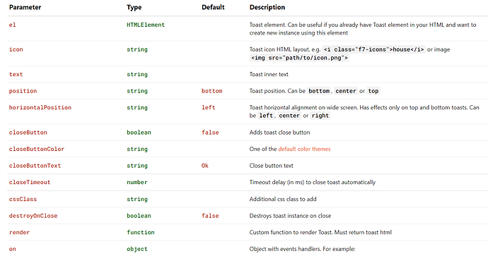

I would like to know where to find the parameters supported in actionFeedback within a Toast. The most I’ve found is this thread with the same question but no solution.
https://community.openhab.org/t/oh3-actionfeedback-parameters/117029
Example:
Code:
actionFeedback: ='{ "text":"You selected <b>' + loop.option.label + '</b><br>Sending command <b>' + loop.option.value + '</b> to item", "position":"center","icon":"<i style=\\"color:green\\" class=\\"f7-icons\\">checkmark_alt</i>","closeButton":true }'
I would need to know the rest of the supported parameters and/or some example.
Thanks!
JustinG
(JustinG)
February 10, 2022, 2:55pm
2
All of these things derive from the f7 versions, so the f7 docs give you what you need to know if you’re interested in this level of detail:
Hello Justin,
I have come to that document several times and tried the following without success:
actionFeedback: ='{ "text":"<b>Generando</b>' + '<br>Espere</br>", "position":"center","icon":"<i style=\\"color:orange\\" class=\\"f7-icons\\">timer</i>", "closeButton":true, "closeTimeout":5000}'
and
actionFeedback: ='{ "text":"<b>Generando</b>' + '<br>Espere</br>", "position":"center","icon":"<i style=\\"color:orange\\" class=\\"f7-icons\\">timer</i>", "closeButton":t"rue", "closeTimeout":"5000"}'
It seems that not all parameters work. Or maybe it’s me…
