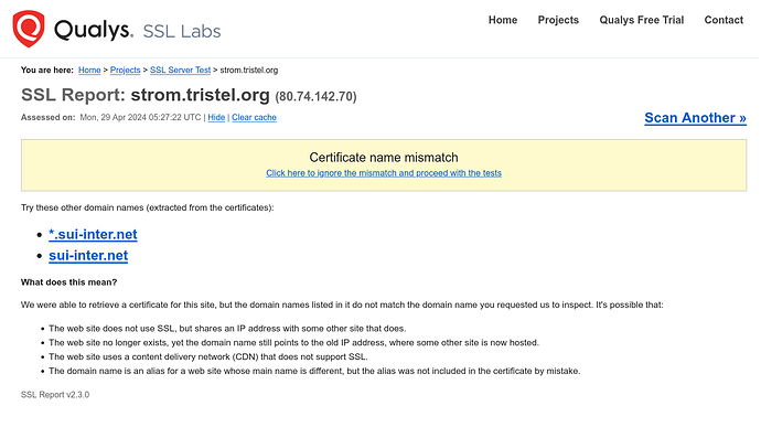

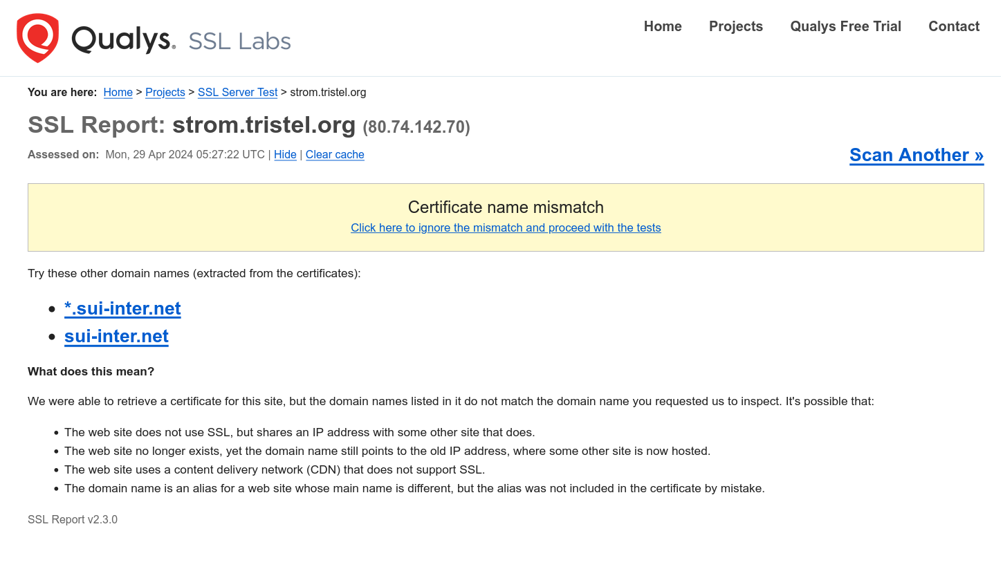

This is more a problem of the certificate that is used on your server than a problem of your rule.
A certificate uses a SAN ( Subject Alternative Name ) that describes the alternative names of your server.
Meaning you can have different names for your server. In your case the name that you use ( in the rule ) is strom.tristel.org. But this name is not shown in the certificate.
To get the names that are used in the certificate you either can use your browser and examine the certificate or e.g. go to ssllabs.com where a set of tests against the certificate and other security settings on your server are examined.
So either create a certificate that contains a matching name or you would have to create a rule that ignores this mismatch of name - which reduces the security.
