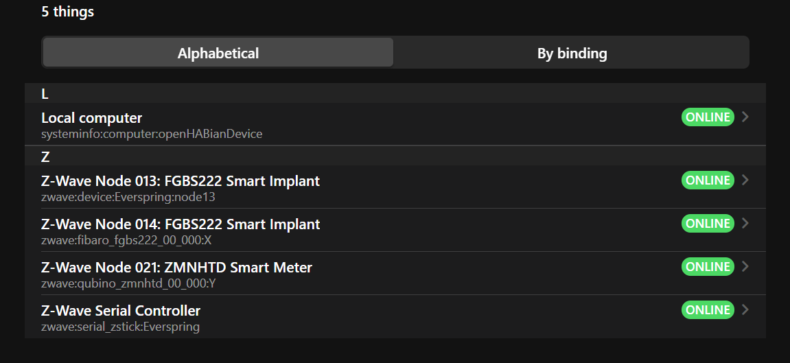

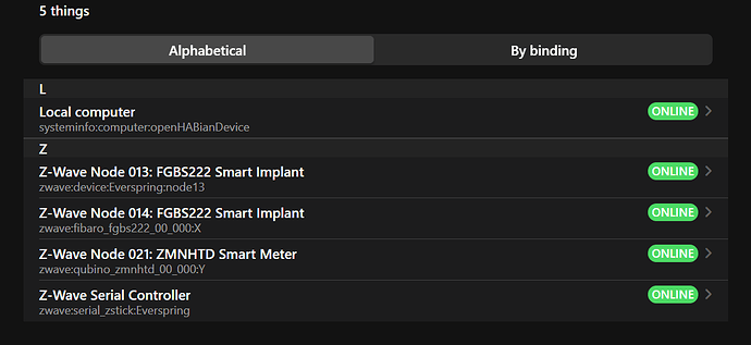

I say ‘with somehow the id I chose’ because, if the default name of a Thing is say ‘zwave:device:Everspring:node14’ (I named my ZWave stick ‘zwave:device:Everspring’, this is the reason why it prefixes my ids with ‘zwave:device:Everspring’ I guess), when I add a Fibaro Smart Implant and choose ‘Add as Thing (with custom ID)’, the UI asks me what I want in place of ‘Everspring:node14’. If I write X the final id will be ‘zwave:fibaro_fgbs222_00_000:X’ and not ‘zwave:device:X’ as I expected.
Fibaro Smart Implant here is just an example, I guess the same happens with all other types of Things, maybe even with non ZWave things. For example I also tried with a Qubino Smart Meter which will be named ‘zwave:qubino_zmnhtd_00_000:Y’ and not ‘zwave:device:Y’ as expected.
Here what I have after trying what I described above:

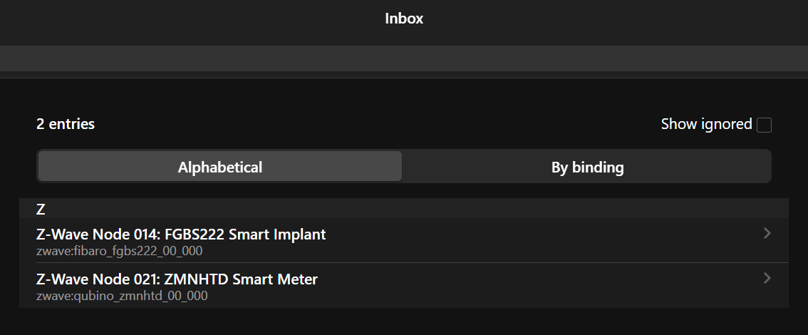

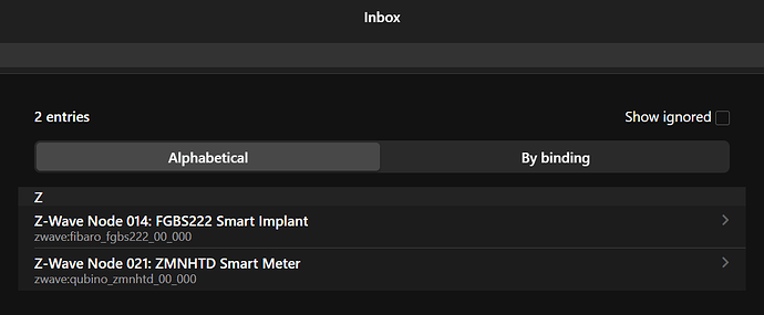

And this is what remains in the Inbox after adding Node 14 and Node 21 by using the ‘Add as Thing (with custom ID)’ option:

  4. after discovery I go to the Inbox and add the Thing by using ‘Add as Thing (with custom ID)’ option, but I change the default ID (only last segment), the Thing is added to the list of registered Things but it also remains in the Inbox. If I delete or ignore the duplicate from the Inbox, it reappears from time to time, for example after a reboot
