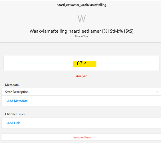

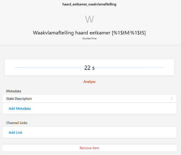

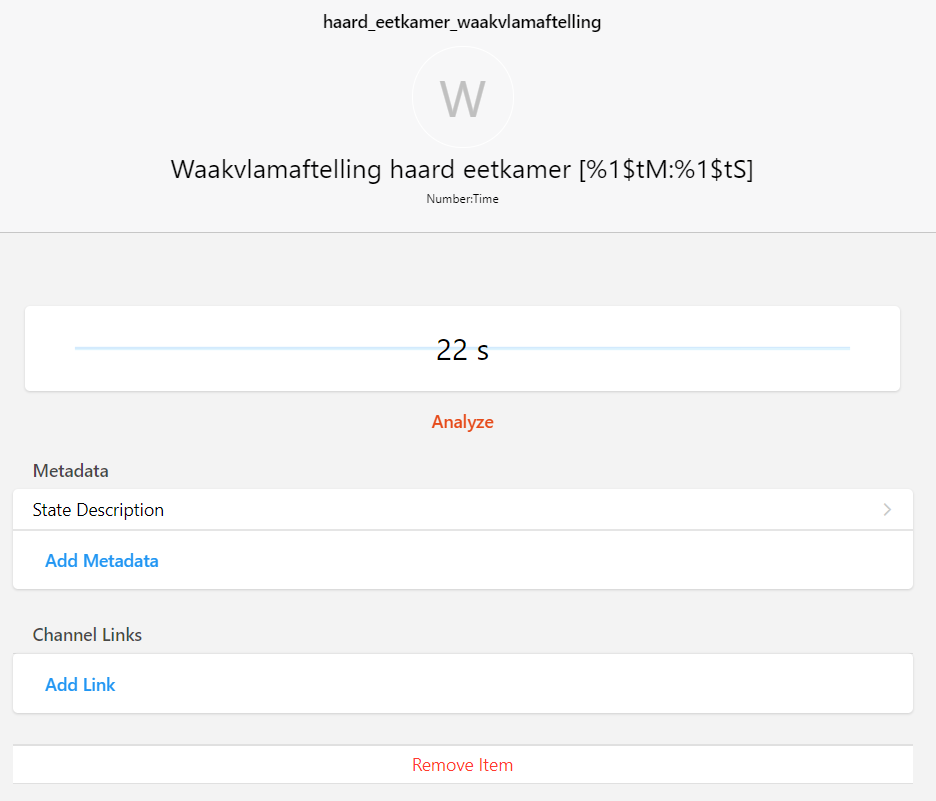

I tried adding an item with the following string:
Number:Time haard_eetkamer_waakvlamaftelling "Waakvlamaftelling haard eetkamer [%1$tM:%1$tS]" {	stateDescription=" "[pattern="%1$tM:%1$tS", min="", max="", step="", options=""] }
But not all went as I expected:
  1. Something unexpected happens with the [%1$tM:%1$tS]. As per the documentation, that’s the proper format, but the substring is also included in the label, which isn’t what I wanted to achieve, obviously.
  2. The pattern isn’t correctly integrated… I assume this no longer works…

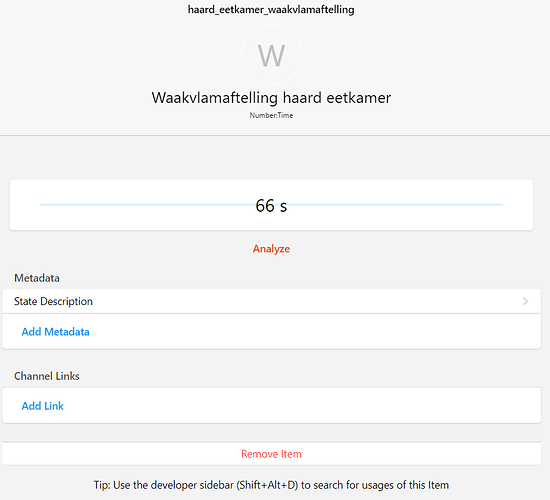

The pattern isn’t used:
Any takers? :slight_smile:

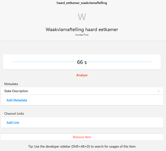

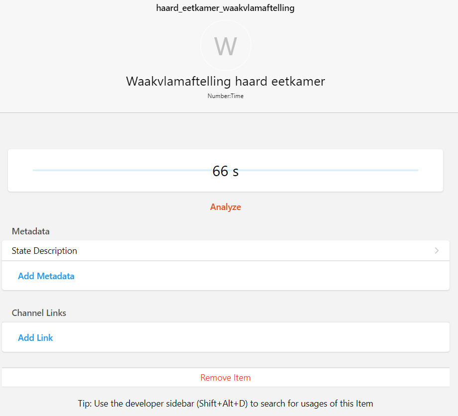

Got it. I deleted and recreated the item, this time with:
Number:Time haard_eetkamer_waakvlamaftelling "Waakvlamaftelling haard eetkamer" {	stateDescription=" "[pattern="%1$tM:%1$tS", min="", max="", step="", options=""] }
But why doesn’t the format work? The item reads 66 s, instead of 1:06?
The pattern is correct, it seems…?

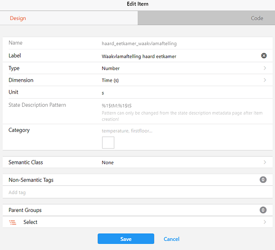

No, I’m using “Add items via textual definition” in the UI.
I think that the pattern you are using applies to DateTime items and not to Number items with Unit Of Measurement time.

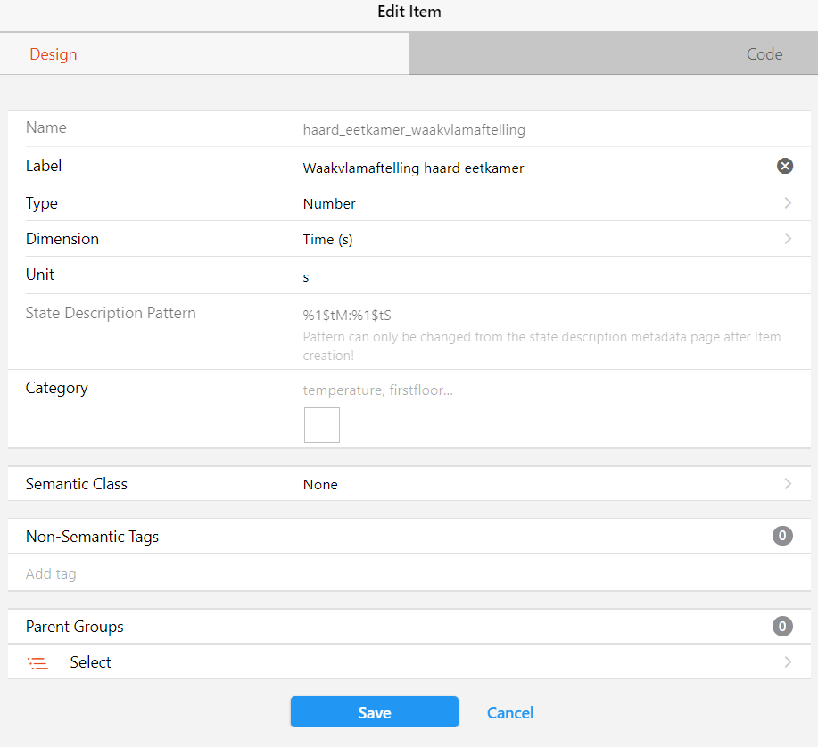

No, the pattern works for an other item, which I made in the “regular” UI way:

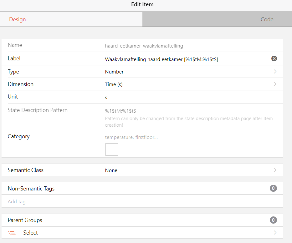

Can you try removing the state description from the item and recreating it?
  1. I don’t know how well the item import from text handles these attributes. There may be issues.
  2. If you delete an item in the UI, the metadata may nog get deleted. So if you import again, it has the old value.
That did the trick. I assume that’s a bug?
