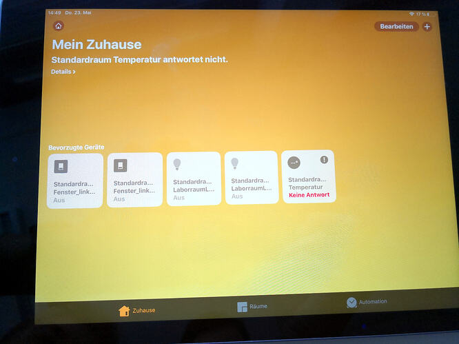

Hello guys,
I want to bind a Max! Radiator Thermostat to my Apple Homekit. Therefore I’ve added the Max! Thermostat in /etc/openhab2/items/home.items on my Raspberry Pi with Openhab2.
The current temperature is working but the item to change the target temperatur won’t show up.
IMG_20190523_144908
Maybe you can help …

Hi Peter,
unfortunally the code doesn’t work that you suggested.
In one way Apple Homekit connects to the Openhab bridge but it’s just one icon without any function, in the other way Apple Homekit shows an error when I try to connect the Openhab bridge.

Hi, I’ve installed the other HomeKit Plugin but the temperatur does still not show up to change it. Only the actual temperature is visible.
