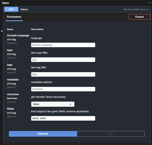

Hello Korbinian, I don’t have an “easy+mass” way to do this but I could propose a “mass” way. using the openhab API:
  1. get all your items from GET /items, only request the ‘name’ field and any other field that you require to identify the relevant items to add to the model. For example:
  2. save the json file to disk and open it with a spreadsheet, add one or more tags columns and one or more group columns
  3. fill the newly created columns
  4. export the spreadsheet to disk, easiest is a csv file
  5. use a program that can automate api calls from a csv file, for example: postman.
  6. use the PUT items/tags and a similar endpoint for entering the groups
Best to start by creating your locations and equipment before doing this offcourse.
This approach is not easy because you need some data manipulation skills (spreadsheet, api, postman, ..). But it allows you to manage certain aspects from a table view instead of item by item. It will depend how many items you’ve got if it’s worth going this route.
