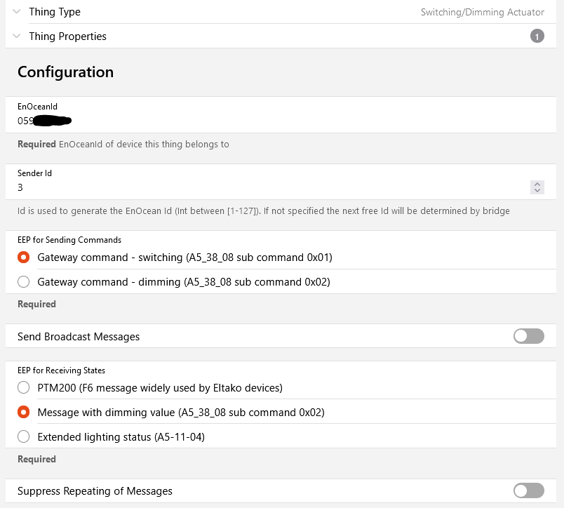

- Now make a scan via the enocean binding. Press LRN on the siren. The siren is found, label is the encocean ID. Add it as a new thing to openHAB. The following settings worked for me:
After that you can configure your items. The siren is activated by a simple switch item. The “last contact” channel does only show the last time the siren was activated.
