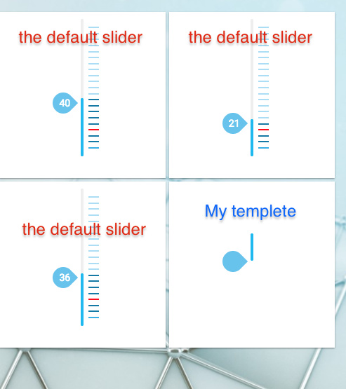

also I made some changes in the css style , but it’s never look the same when using the builtin slider widget
also the options like ‘showTicks’ is not working in my template
I have the exact same issue. I’ve tried different ways of defining the slider in the code to make it vertical, but it won’t work. I tried the ecobee widget to check the code and the behaviour, and same thing, it doesn’t work for me either.
I’m working on the openHAB 2.1.0 - release build. I don’t know if there can be a bug in this version or if I’m doing something wrong…
I face the same issue w/o changing css properties: I am not able to create a template with a vertical slider. The slider’s height is not changeable, and pressing on it removes the slider and shows the handle only.
