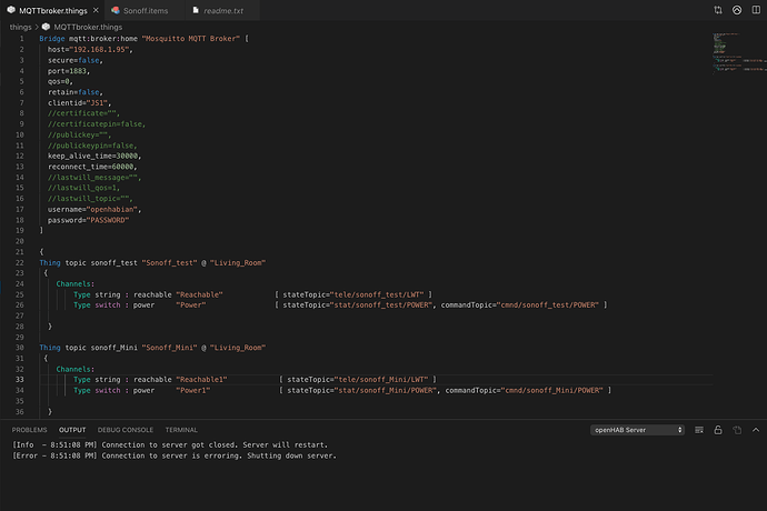

I’ve created a mqtt.thing file with this in it. Shouldnt create an MQTT broker thing for me automatically in the paper UI?

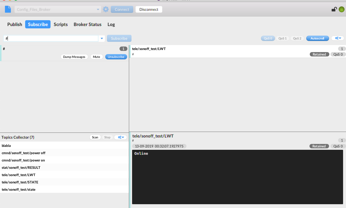

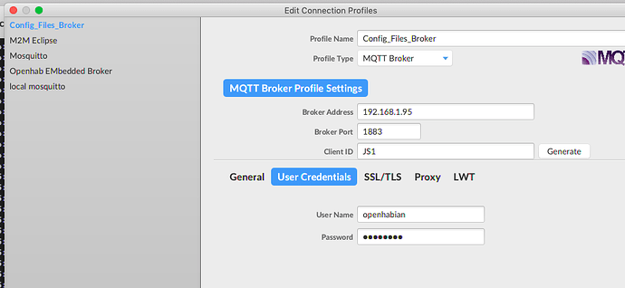

Also, I use mqtt.fx to simulate the broker (?) with the below settings and user name and password but when I subscribe, it can see the sonoff device I have (with tasmota) but can’t send commands:
As you can see, the status is online when I subscribe and the sonoff_test is present

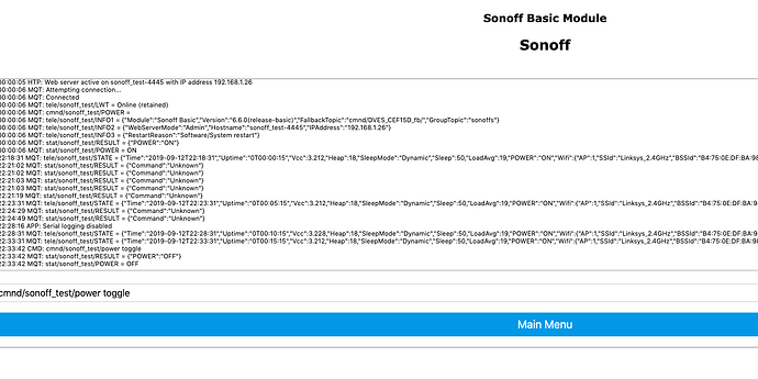

I managed only to send command from the IP link of the Tasmotta page console and it worked.
Getting close…thanks
Yes, such created Broker Thing should be visible on PaperUI, as any other Thing created by file, however you can’t CHANGE then via PaperUI.
The screenshot doesn’t show the end of the file, I’m missing the closing ].
when working with files, it’s always good practise to have /var/log/openhab/openhab.log tailed so you’ll see if you have any errors in your files

separate your broker from other things, because when you have it like that → any change in that file will lead to mqtt broker connection restart

just create a file under things called bridge.things and put this into it
Bridge mqtt:broker:home "Mosquitto MQTT Broker" [
  host="xx.xx.xx.xx",
  secure=false,
  port=1883,
  qos=0,
  retain=false,
  clientid="someid",
  //certificate="",
  //certificatepin=false,
  //publickey="",
  //publickeypin=false,
  keep_alive_time=30000,
  reconnect_time=60000,
  //lastwill_message="",
  //lastwill_qos=1,
  //lastwill_topic="",
  username="",
  password=""

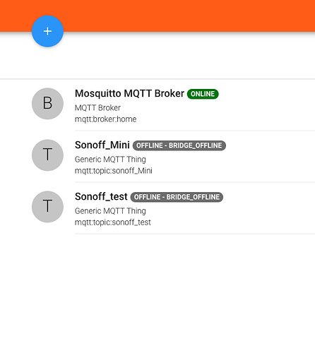

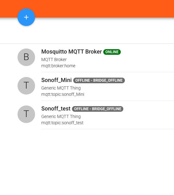

Here is the current situation.
ANd the broker is in a separate file
and the sonoff.things have this code

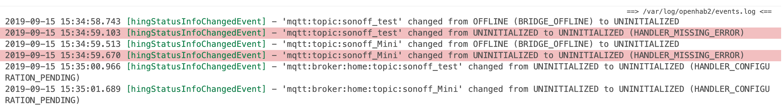

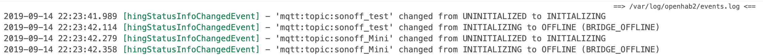

The log shows this:
There is still nothing there to tell openHAB that this Thing has anything to do with the broker you defined elsewhere as mqtt:broker:home
You need an extra bit in round brackets pointing at the broker Thing, and I think you need to refer to it in this Thing’s UID as well.
Thing mqtt:topic:home:sonoff_test “Sonoff_test” (mqtt:broker:home) @ “Living_Room”
I am getting the below when using your convention in the code (last two messages):
Even though I split the files as instructed @kriznik @opus.
