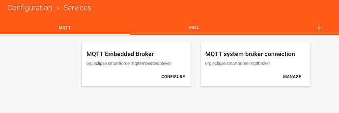

I have a doubt regarding the following as embedded broker is used and not mosquitto:
Bridge mqtt:broker:mqtt “Mosquitto” [ host=“localhost”, port=1883, secure=true, username=“mqtt”, password=“PASSWORD”, clientID=“JS1” ]
You can do it via files. It wasn’t clear that you are using files already.
I can not say wether you have more then one mqtt broker running, you need to check that yourself. What did you install?

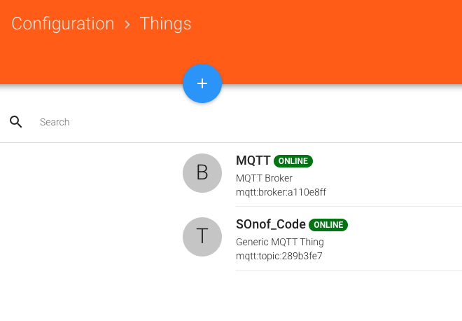

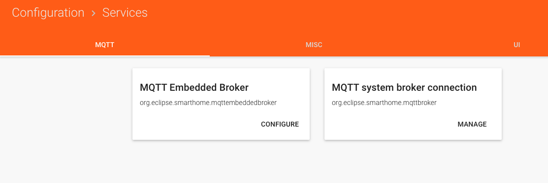

In the Services I have 48%20PM
In the things, I have:
52%20PM
when first installing openhab on PI, I’ve installed Mosquitto from SSH configuration but I dont think it’s configured

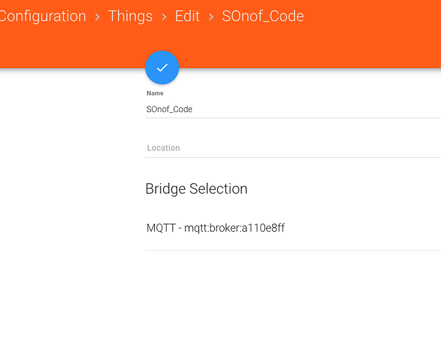

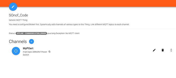

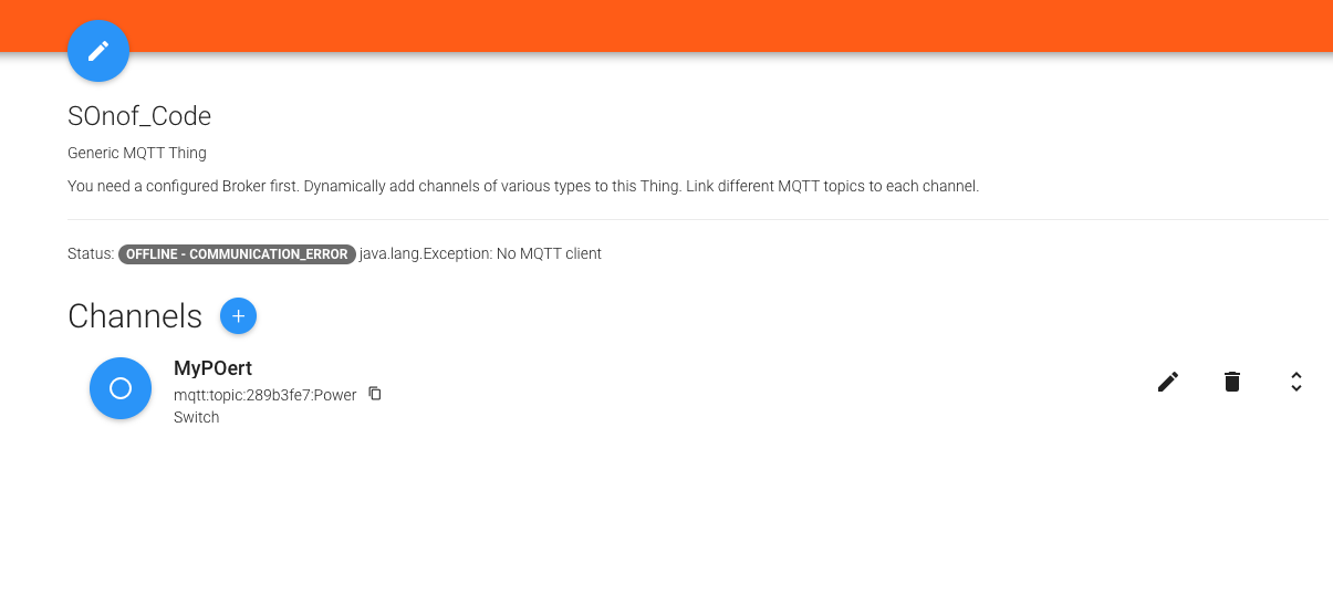

When I add a chennel to the SOnof_Code with the following in the configuration:
stat /sonoff_test/power and cmnd/sonoff_test/power the MQTT thing will become offline saying No MQTT client
22%20PM

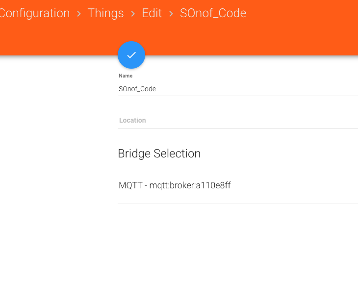

and the bridge in config is as follow:
21%20PM
only when adding / configuring the channel it becomes offline

Note: Your used version of the MQTT binding has a bug, whenever you change the setting of the MQTT Things you need to restart (either only the MQTT Bundle or openHAB). That migth explain why your things go offline when creating a channel.
