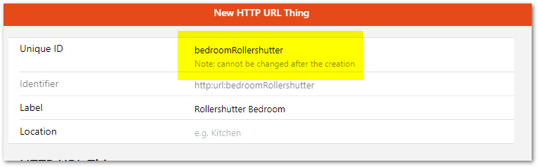

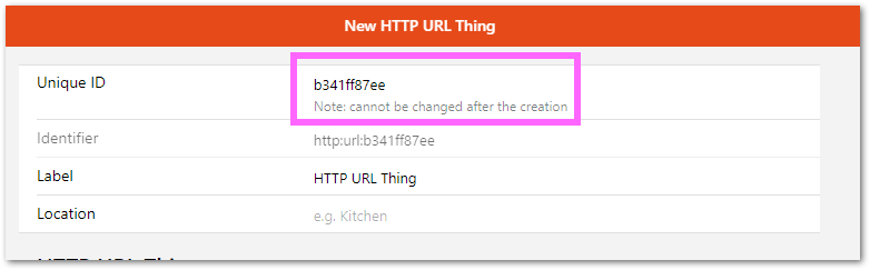

  1. Create the things in UI
Use proper thing names while creating. Not the generated hashes.
Wrong:
Correct:

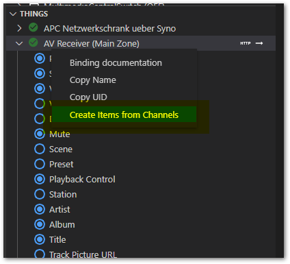

2. Create the items with item files (odlschool) and vscode extension…
Make one dummy set of the needed items.
Copy that the needed times.
Replace the proper channel names for each rollershutter.
Use those items.
