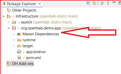

Before seeing this solution I tried different stuff in these settings:
But I did something that made that entry go away… Now it looks like this:
Is that okay? Or should something be fixed? I can “run” the openHAB demo version without issues.
I don’t really know for this one, but I think that if it works, then don’t worry.
