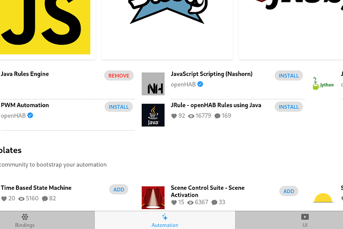

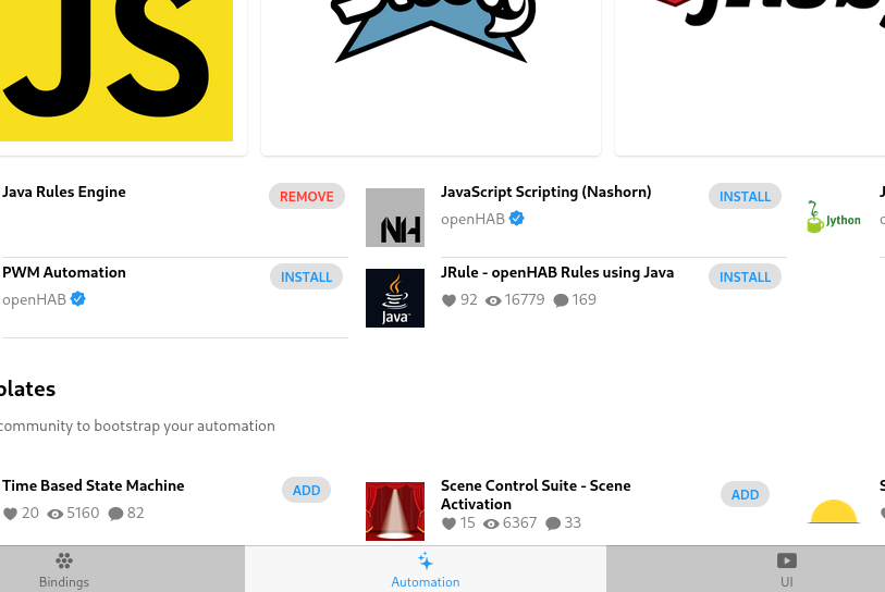

You can install it from the Addon-Store under automation.
It is somewhat old the version in the addonstore, so I recommend cloning the repo and building it yourself.
