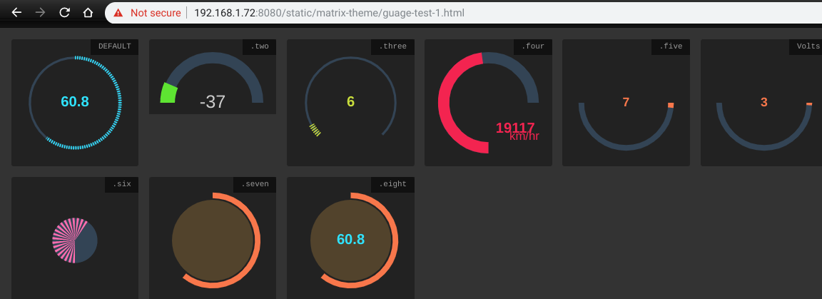

Saving the code from the live demo into an .html file, modified using “static” urls for adding the .js file the gauges are animated when i open in a webpage “192.168.1.72:8080/static/html/matrix-theme/gauge-test-1.html”. The “gauge.min.js” file is also in the folder.

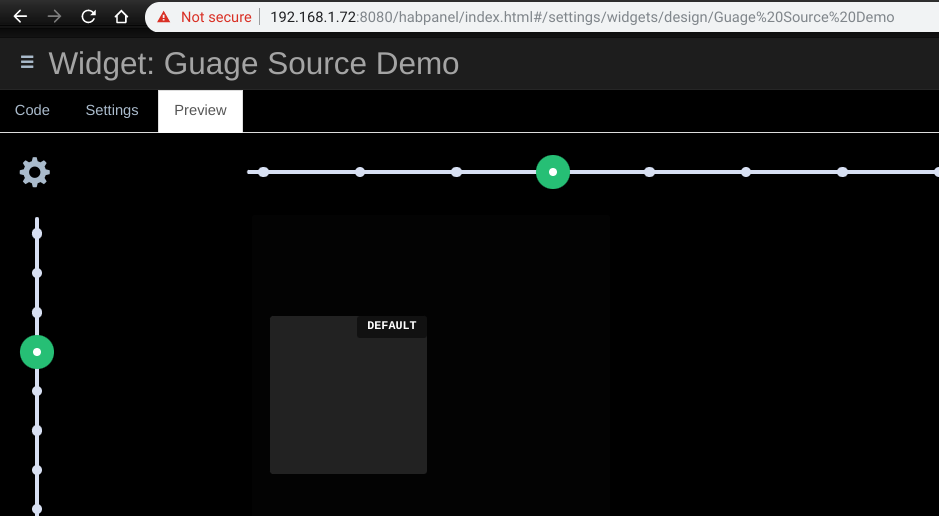

I have added a dashboard to Habpanel and created a widget containing the following code, modified to only display one gauge::
    <div oc-lazy-load="['/static/matrix-theme/gauge.min.js']"></div>

    	<script id="rendered-js">
        var gauge1 = Gauge(document.getElementById("gauge1"), {
        max: 100,
        value: 50,
    	gauge1.setValueAnimated({{itemValue('ZW010_Washer_ElectricMeterKWh')}}, 1);
    	</script>
I realize some of the style items are not needed but have left them in place and will add the needed items into a loaded css file later when/if i can get this working.
This is what is displayed:
The light colour block with the title “DEFAULT” should have the gauge in it.
Using the Chrome Developer Tools i do not see any errors, and the gauge.min.js looks like it is being loaded. My HTML coding skill is very basic, js knowledge almost non-exisitant, and have been learning using the Matrix-Theme by modifying it to my setup. I have been Googling for quite some time trying to get this sorted and to learn, however am stuck and need some help.
