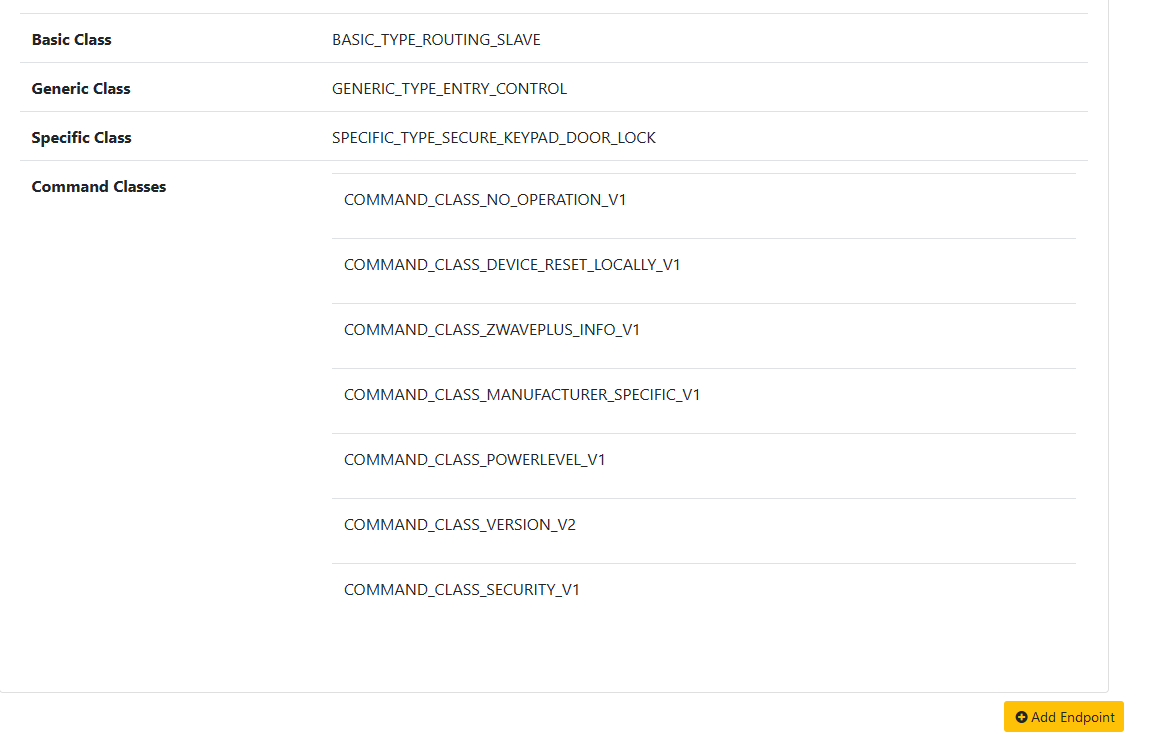

I am trying to add a new device to the Z-Wave Device database. I got most of the configuration inputted, but I am unable to add/edit command classes and channels on the Endpoints tab. Here is a link to the new device - OpenSmartHouse Z-Wave Device Database. I am trying to get the endpoint configuration on the new device similar to the YRL256 device.

You need to upload the xml from your userdata/zwave folder, all endpoints will be included then automatically.

I did upload the xml from the userdata/zwave folder from OH2. But some of the required command classes were not identified by OH and were not included in the xml.

I agree that there are no channels in my XML. Some command classes are also missing based on the documentation. So how do I add the missing command classes and channels?
Usually that comes from the xml file and the source of that data is your device firmware. If classes are missing either discovery was incomplete or the documentation is in error.

You need to securely add door locks.
Include through the binding within 15 seconds, don’t remove the stick from the server for inclusion. Reset the device between attempts.
Read the binding docs for more information.
Thanks for the help. I was able to include the lock device securely. OpenHAB generated a XML file with the complete list of command classes.
Now my question is how to import the new XML into the Z-Wave database - can I import it over my existing database record or do I need to delete the current database record and start over?
You can import it over your existing record if it currently has no Endpoints, I believe.
