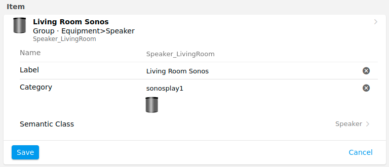

Most people just drop their custom icons files into the $OPENHAB_CONF/icons/classic folder. Then you can set them in the mainUI just like classic icons:
