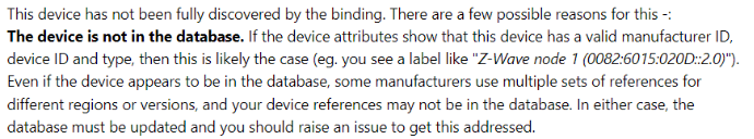

The problem is now I can’t add items and it’s showing under channels that it’s not done discovery. I’m not sure what to do/try, they’re just genertic z-wave dimmers.

The usual reason for the no channels shown is the device is not in the DB. Normally for powered device the device gives up those numbers quickly. Since that information has not been provided the assumption is that your system is not working normally, hence the suggestions. If you have five lines on the device UI page
and an XML in the var/lib/openhab/zwave folder for that node please provide that information. It is needed for you to add the device to the community-maintained DB. If not, something is wrong on your end.

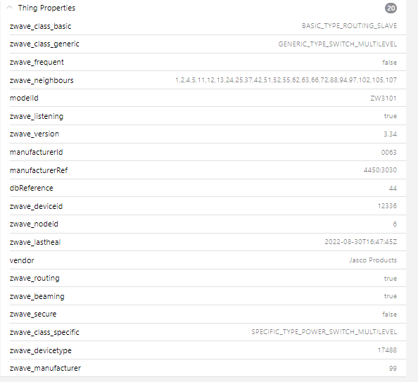

Since finding the zwave folder with the potential XML appears to be a challenge. (Note that XML will be required to update the DB), post the results of the UI page- Thing properties like this;
