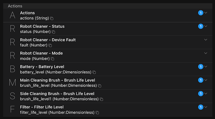

The channel for the generation of the json config file worked and I’ve got all miot-channels available (https://home.miot-spec.com/spec/roborock.vacuum.a38).
