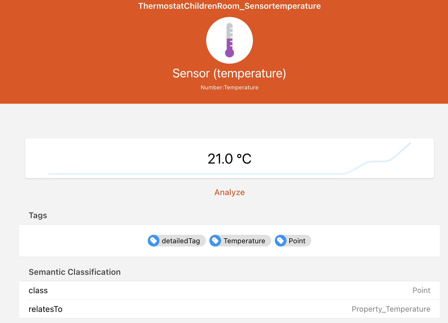

I seem to be unable to get more granular values than the default “EveryMinute”..
I’m trying with the following persist file:
Strategies {
every10Sec : "*/10 * * * * ?"
everyMinute : "0 * * * * ?"
everyHour : "0 0 * * * ?"
everyDay : "0 0 0 * * ?"
default = everyChange
Items {
* : strategy = everyChange, everyMinute
detailedTag*, Temperature* : strategy = everyChange, every10Sec
I need values in the group Temperature to be persisted in influx every 10 seconds..
Persist file seems to be correctly loaded at each service startup..
2022-10-14 10:32:34.137 [INFO ] [el.core.internal.ModelRepositoryImpl] - Loading model 'influxdb.persist'
There are no errors in my logs.. (checked with LOG:SET DEBUG org.openhab.persistence.influxdb).
Thanks!

I think you are confusing Tags and groups
I think it is Part of this
not of this
Because Temperature* means all Items in the Temperature Group . I am not 100% shure but i think you cant use a tag here.

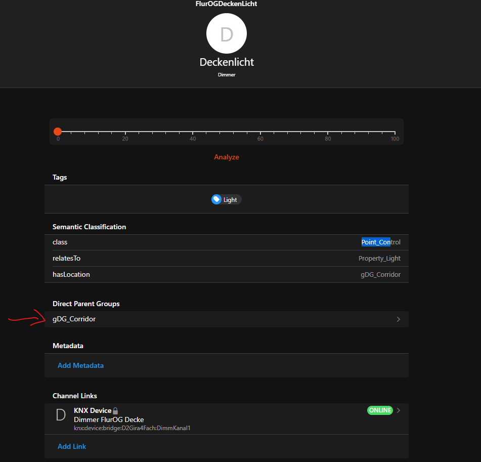

Where the red arrow is you should have Temperature in your item.
This item here is Part of the gDG_Corridor Group… as an example

I thought I saw some users using tags to declare items there. It seems flexible that way instead of declaring each by name. So it seems like I can’t mark items I want to persist more frequently in UI.. I don’t see Groups anywhere in UI.
As i told you i am not shure.
but you could create a group named Temperature. Simply add this to any *.items file
Group Temperature
An then go to the item in the UI, add it to that group and see if it works.
I read nothing about Tags in the documentation of the persistence file
let me know if this works.
So it seems like I can’t mark items I want to persist more frequently in UI… I don’t see Groups anywhere in UI.
I never made Groups in the ui, but i think its what you create under model in the settings
opus
(Jürgen Baginski)
October 14, 2022, 4:24pm
8
You can create an item of type Group!
