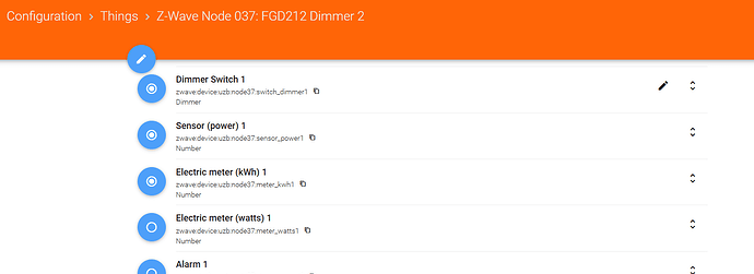

I finally got it to work! And the node now comes up as it should, and I can control my light using the paper UI.
Next up is to configure the Dimming node to one of the channels on på In-wall sitch(2channel).
I`ve been reading some aboout it and found this:
Is this something I can do in the OH2 Paper UI, or is this only through the xml file?
If it is through the xml file, do I just write the commands(in the link, ofc with my node ID etc) and just save the file in the userdata folder?

Not through PaperUI nor through the xml file. You need to do this through things files:
You need to link the Channels of your Things to your Items.
Usually one autodiscovers Things (don’t use the manual things files you mentioned above) and link the Channels through Items files.
zwave.items:
Dimmer FibFGD212_1_Dim { channel="zwave:device:uzb:node37:switch_dimmer1", autoupdate="false" }
