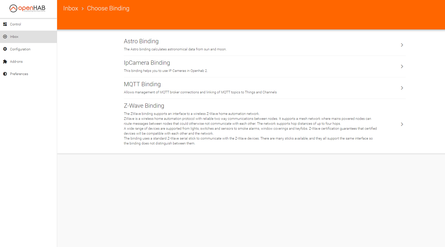

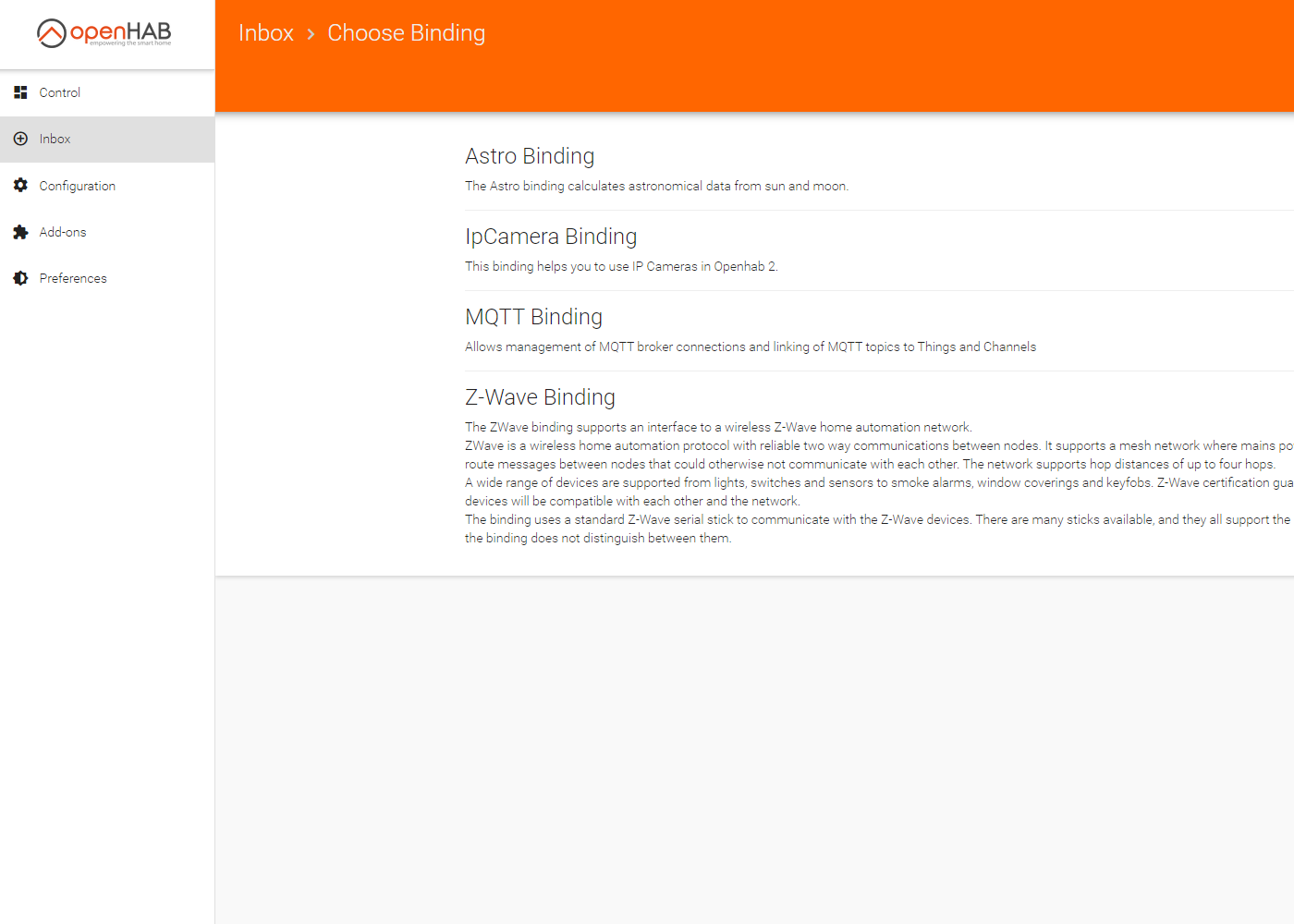

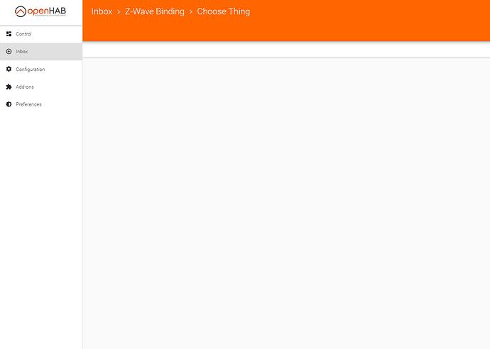

I go to Configuration > Things, then click the + button and select the Z-Wave Binding and it brings up a screen that says “Choose Thing”. But there’s nowhere on this screen where I could add my stick. Am I in the right location, or does this need to be manually added elsewhere?

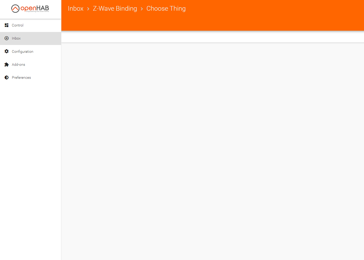

I’ve tried that, but there’s nowhere to enter anything. I go to Inbox, click “Search for Things”, then click the ZWave binding. But then I get a blank screen with “Choose Thing” at the top…I can’t add anything here.

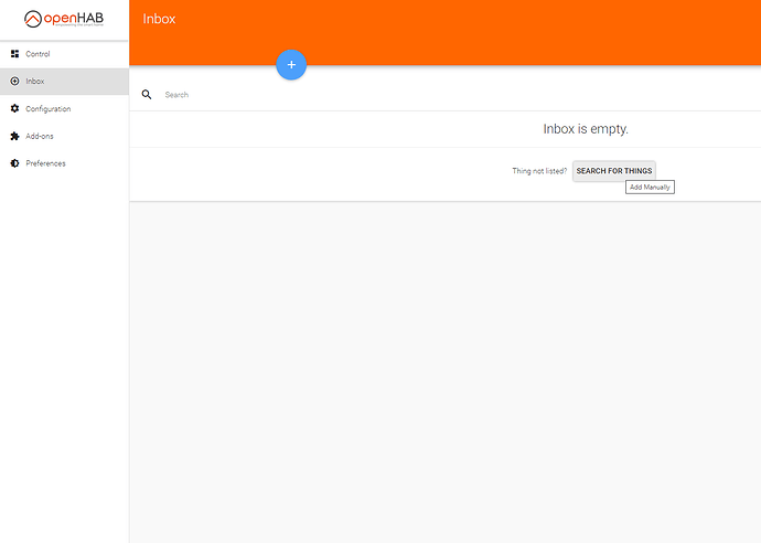

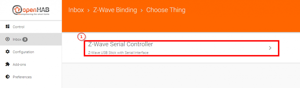

I don’t have an OH2 instance running anymore to verify this, and I can’t remember how I did it myself… But if you click the blue plus button on the things page rather than the search button at the bottom, are you presented with an option to manually add a controller?
I think either the binding isn’t installed properly or it’s not detecting my USB stick. Would a USB stick need to be present for the option to manually add a controller show up?

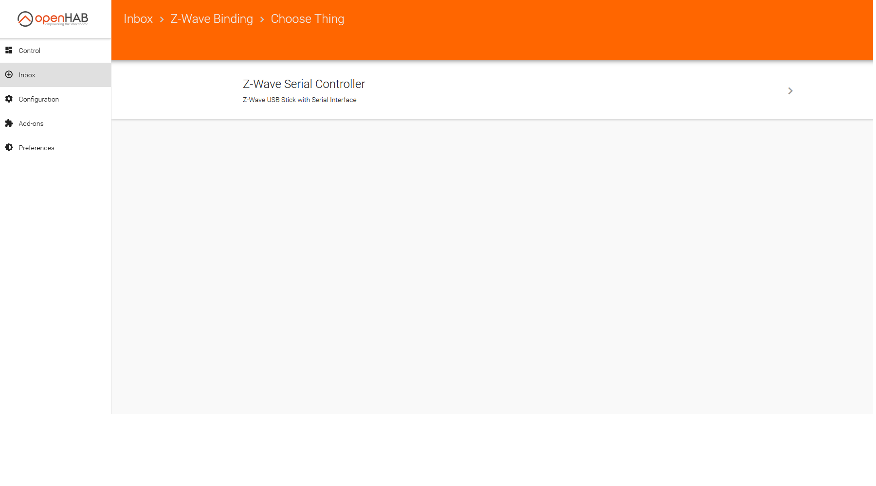

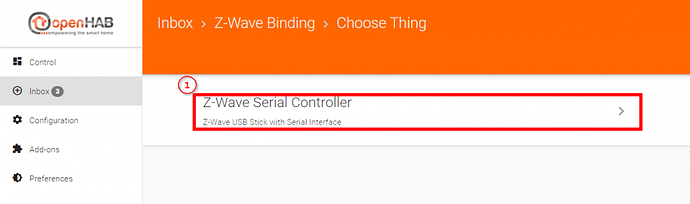

Ugh…okay, I’ve got it. Apparently the option Z-Wave Serial Controller doesn’t show up in my environment when I’m going through my reverse proxy. If I go directly to OpenHAB it does show up.
