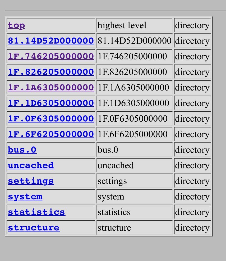

Are the „child sensors“ detected in the root directory of owfs or are they only found as child’s of the hub?
Hi Jan,
Here is the ‘root’ directory:
The first entry, 81.14…, is the DS1420 USB interface. The next three entries are the three ‘branches’ of a hub. Then the last three entries are three ‘branches’ of the other hub.
Each branch has an ‘aux’ and ‘main’ sub-branch.
Yes, each sensor is in a branch, not in the root.
