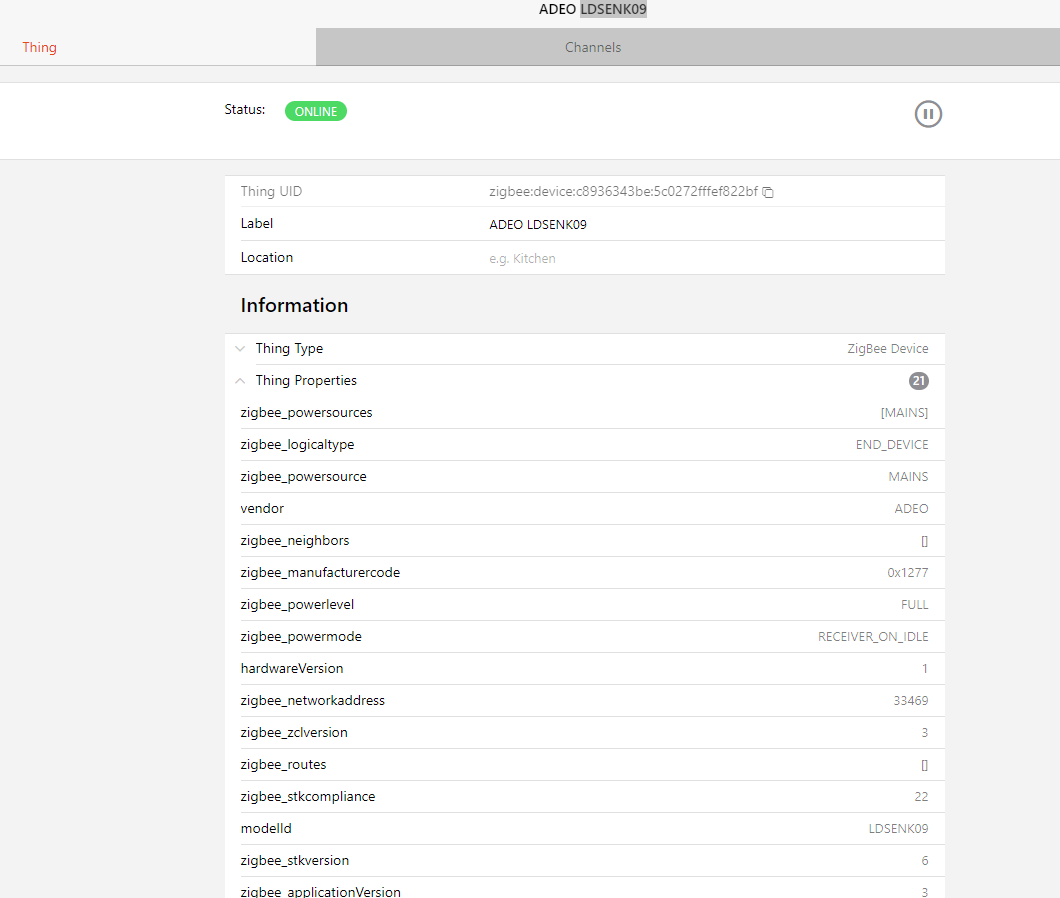

I try to make this zigbee devices : Adeo Lexman Smart Compact Keyfob LDSENK09 Zigbee compatibility worked with openhab. This is a four button remote device, use for alarm / presence system.
The devices is correctly pairing and detect in openhab.

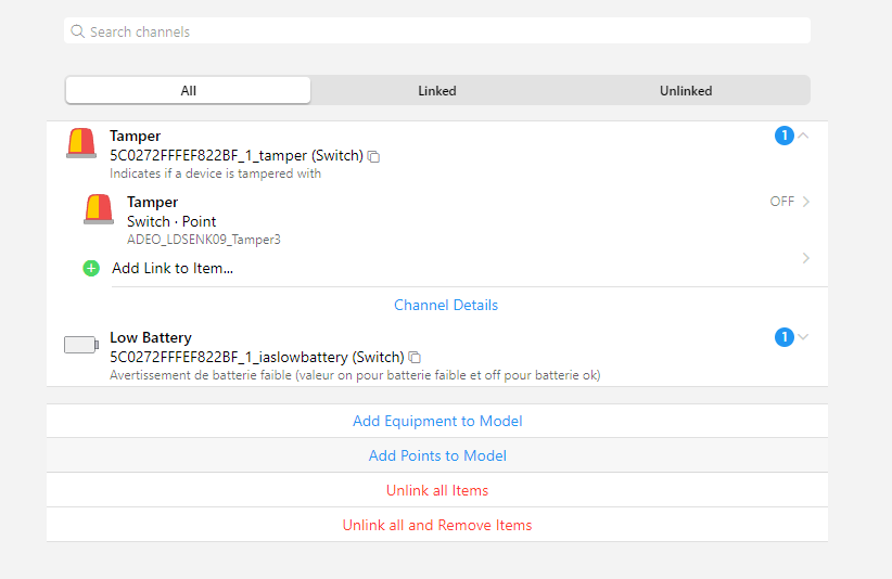

But the channel list seems to be incomplete, there is no channel for the button press result:
And i’m not able to get proper communication when pressing button with openhab.
